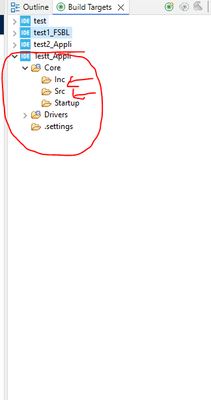

I am using Stm32 N657X0-Q board with a stm32cubeide version 1.18, started with creating new project-> gave name-> selected appli in project structure-> selected gpio pin PA5 as output -> and generated code but in code generation under core-> there is no related files inside src and inc folders. can you help me in how to use this board.

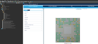

Hello @Mahmoud Ben Romdhane  thank you for your quick response... I am using STMproducts from past three years. there is no problem with older version of cube ide . issue with new cube ide software. below is the proper procedure what i am trying to do.
i gave filename and selected appli option and then finish
It was asking these option i kept it as it is
Then selected PA5 as output
Then i clicked generate code
It created only inc and src folders , there is no related folders and files

There was a problem with stm32cube IDE version1.18, i have downgraded to 1.17 now code generation are working... but once the code is uploaded and after pressing reset code stops working. that is i am writing code to blink green led, everything works as soon as i upload a code but stops working after pressing reset button. can you help me what changes i have to make.
