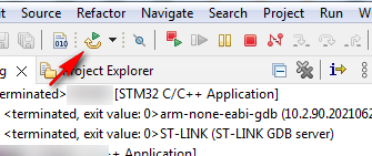

It happens only when I restart the target with
Then it opens a "random" file but the file opened is the code which was running when the target was reset. Which file is opened, is wherever the CPU was when the above button was pressed.
So the file opened is not "totally random" but is not desirable to have it opened; it serves no purpose. It means that if you restart the target say 20 times, you get 20 file openings, and depending on where the CPU spends most of its time, you may get 20 different files, or fewer. If for example CPU spends a lot of time waiting on some mutex, then over 20 restarts you will get mostly tasks.c (the FreeRTOS main file) opened, but you may get other files so if e.g. the mutex is around some SPI code, you will get tasks.c and sometimes spi.c. Eventually you will get loads of different files opened.
This probably explains why some people get it much worse than others.
