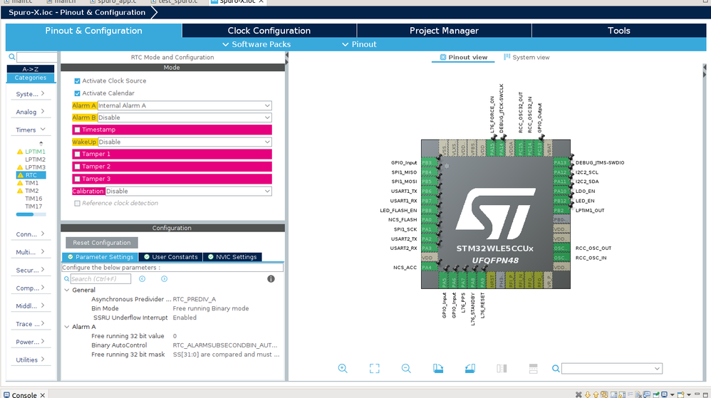

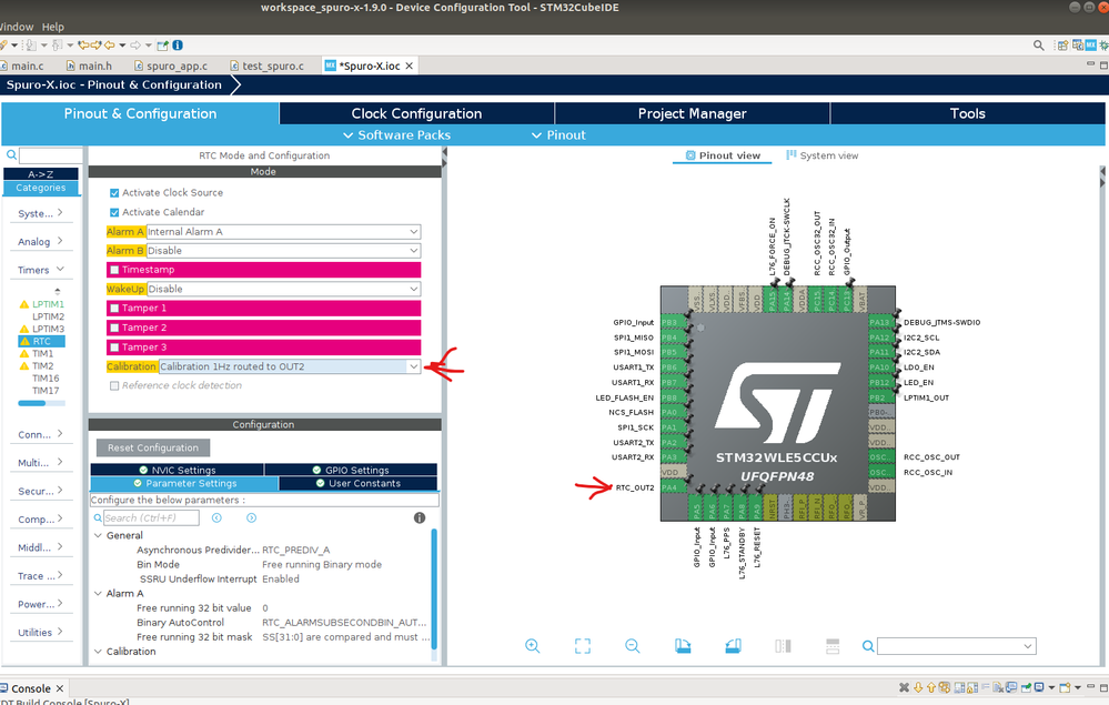

Then I enable RTC Calibration output on PA4

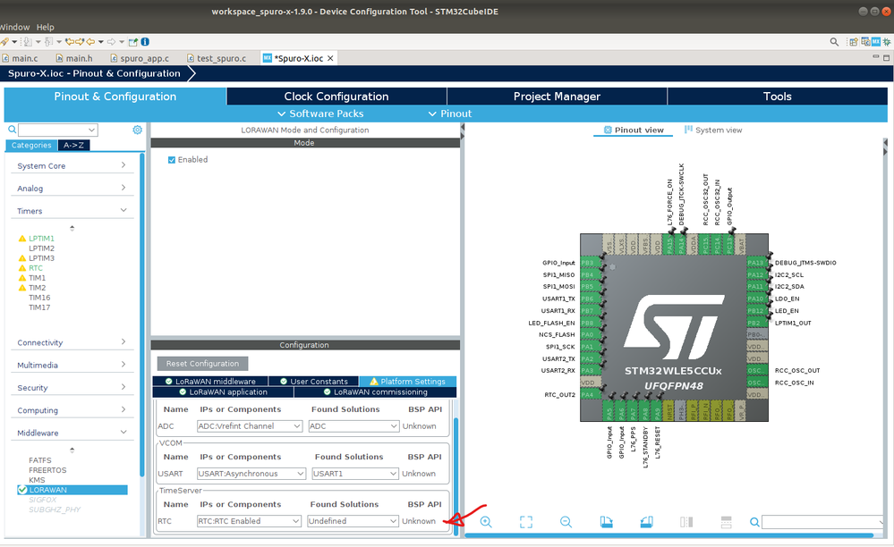

This silently makes lorawan settings glitch. Very easy to miss.
If I change "unknown" back to "RTC", then everything works as expected.

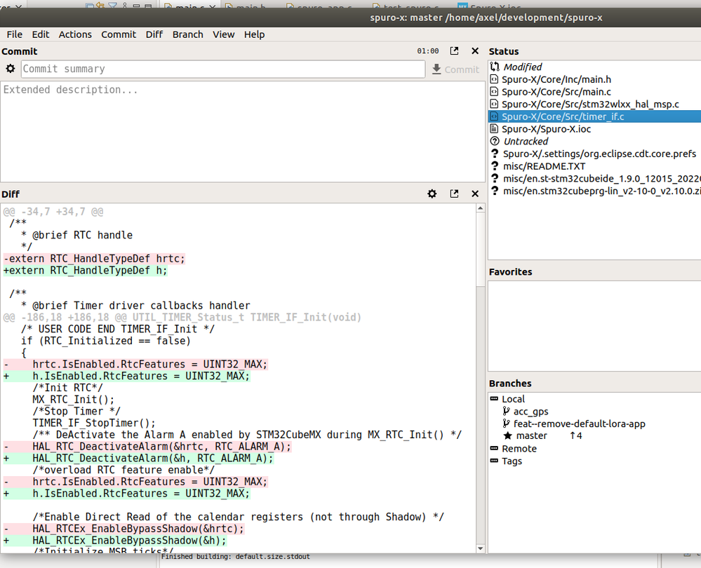

But if code is generated now, then we will get the AfterGlitch.ioc file (attached) and and we have the issue of hrtc renamed to h (among other things), see image below.

Hi @AAlat.1​
Thank you for your contributions and for your detailed explanations,
I confirm the issue on my side, it has been reported to STM32CubeMX development team .
Internal ticket number: 133317 (This is an internal tracking number and is not accessible or usable by customers).
I will keep you posted with updates.
