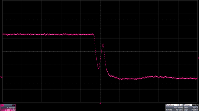

Few days ago i've encountered a strange behavior of the comparator at STM32G4. I investigated the problem under controlled conditions (used Nuclo kit instead application PCB) and the result is startling.
Comparator 4 configured to get positive input from pin PB0, negative from DAC1 Channel 1 (set to 500mV).
Hysteresis set to maximum (70mV)
DAC output is not connected to external pin (only internal connection)
Input signal is 50Hz sinewave with 400mV amplitude and 600mV offset (to reliably cross 500mV thresholds +- hysteresis)
Enabled Comparator 4 rising edge interrupt.
Interrupt routine simply generates fixed length pulse.
On blue scope trace you can see clean input signal (scope input AC coupled), it certainly does not contain noise that would be close to hysteresis value (more detail at last screen).

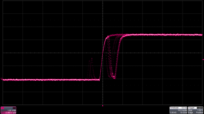

On Red trace is application output. You can see that many times interrupt fires also on falling edge, or fires multiple times on tha same rising edge. It looks like that comparator works withou hysteresis. But if you take a look on next screenshot, you will se comparator HW output (yellow) witch marked thresholds. They are separated by about 40mV which corresponds to "typical" value of "70mV" hysteresis. And of course, comparator registers are correctly set to hysteresis level "7".
On yellow trace is comparator HW output (PB6)
Last screenshot shows that there is not excesive noise to "false" trigger comparator.
False falling edge detectionFalse falling edge detectionDouble rising edge detectionDouble rising edge detectionHysteresis provedHysteresis provedSmall noiseSmall noise

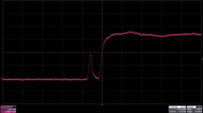

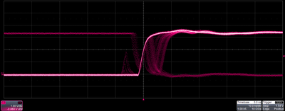

It seems that a comparator with 70mV hysteresis which is flipped by less than 10mV noise is not an interesting topic. To be sure that i am not wrong, i've measured comparator HW output by 1GHz active probe (included screenshots).
I will summarize the observation:
1. EXTI often catch rising edge on comparator output even input signal is falling
2. Input signal noise (<10mV) is much less then comparator hysteresis (nominal ~70mV)
3. That happen even if any fast or sensitive signal is outputed from MCU (comparator HW output disabled, DAC output only internal)
4. Regardles of MCU clock frequency (16MHz or 170MHz)
5. Nasty spikes can be seen on comparator HW output if enabled (and pin speed set to maximum) - I susspect these spikes are inside MCU and are source of problem (EXTI is fast enought to detect them).
Anybody who will want to detect "reasonable low" noise slow rising or falling edge by comparator on STM32G431 will have to find some workaround.

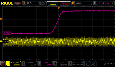

I am not using S&H mode and blue traces are measured at input pin. Thanks to pointing on VREF+. STM32G431 have VREF+ hardconnected to VDDA. I checked the VDDA supply voltage and it is clean (SB5 jumper on G431KB nucleo removed). I also tried bring DAC output to GPIO and add filter (22nF to GND) and with no effect. DAC output voltage is clean too. I've didnt tested ground bounce, but i suppose that ground impedance on Nucleo32 kit is low enought. And moreover i've measured the same behaviour on two different PCBs with exactly the same "glitch shape".
To summarize:
6. Enabling, disabling compartor output neither its slew rate have no effect - no fast signals outside MCU
7. AVDD looks clean (scope trigger synchronized by comparator slew limited output), DAC output (if used) looks clean the same way (trace included).
8. Changing comparator negative input from DAC driven to "internal Vref" driven have no effect. Exactly the same output glitch shapes.
9. Lowering input waveform slew rate to stay at threshold voltage for a longer period of time have no effect. Duration, rate and shape of spikes are the same.
Used comparator 4 have no external connection for negative input. To test fully externaly controlled comparator i have to change test setup. That may or may not bring another information about cause of problem. But probably does not change anything on original problem with comparator with internal DAC/Vref threshold.

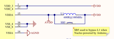

by the way, what is purpose of SB5 ?
waclawek.jan
Sorry, I have nothing relevant to add.
This?
No idea...
