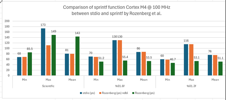

I did some comparative testing against the Berkley printf/sprintf functions and found the following:
Three different number formats were used, Scientific, float to 6 decimals and float to 3 decimals. I tried the Rozenberg with double format on and off,
so there are two data sets for this sprintf function. Of course the maximum time to do an sprintf is the limiting factor in therms of speed and it shows that the Rozenberg
is considerably faster than the stdio for the float with three decimals case. Scientific notation is very slow with a maximum time of 173 us for the stdio and 149 for Rozenberg.
If you need speed go for floating point and keep the precision as small as practical.

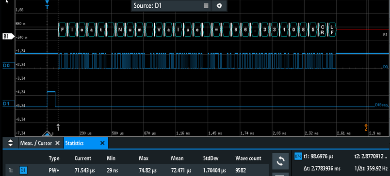

 I used my scope to get some timing:
The top two traces are the output of the uart with a decode. The Uart is set to 115200 baud.
The bottom trace is the time it takes for the printfdma function to decode the run sprintf and place the
data in the queue.
As you can see the printfdma function takes a maximum time of about 75 us, with the transmit time being
being about 2.5 ms. If you print integers or simple short literal strings the time is much faster, probably less than 20 us.
