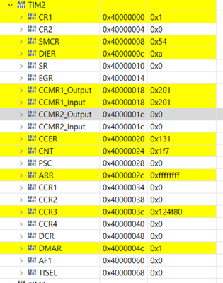

Timer registers after all initialization and starting channels:

> I tried setting UG bit and CC3G bit in EGR, but did not help.
Observe the TIM registers after doing this: if both TIMx_SR.CC3IF and TIMx_DIER.CC3IE are set, and this did not result in the expected CC3-related interrupt service routine being called (while taking into consideration that during single-stepping in debugger interrupts are usually suppressed by debugger, i.e. you have to confirm in debugger that both above flags are set and then let the program continue running), then there's something wrong in the interrupt invocation fabric: either relevant interrupts are disabled in NVIC, or things got lost somewhere in Cube/HAL.
I'd suspect the latter and I'd write my own ISR, discarding whatever Cube/HAL is doing. I don't use Cube.
