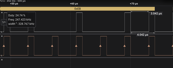

I am porting an old application made on AVR to STM32, and I am facing a strange timing issue.

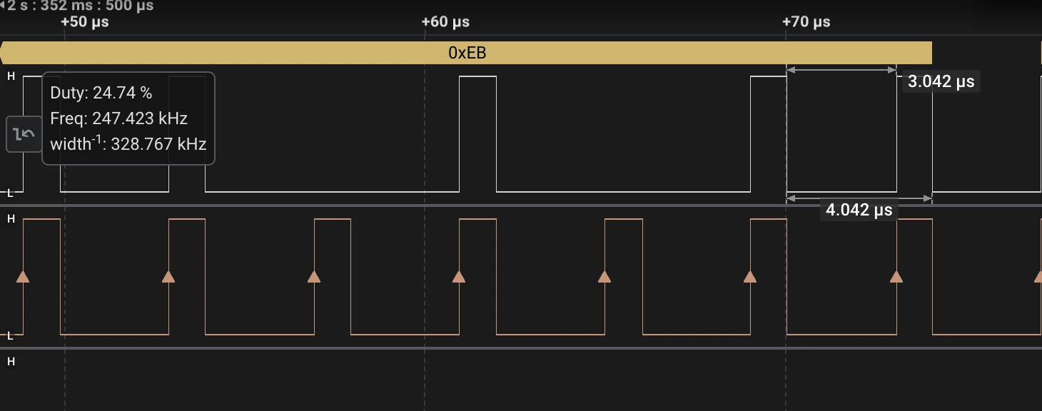

In a nutshell, the application is reading sector (512 Bytes) from a SDCARD and output the content of the buffer to GPIO with 4us cycle (meaning 3us low, 1 us data signal).
The SDCard read is working fine, and I have written a small assembly code to output GPIO signal with precise MCU cycle counting.
Using DWT on the debugger, it give a very stable and precise counting (288 cycles for a total of 4us).
When using a Logic analyser with 24 MHz freq, I can see shift of signal by 1 or 2 cpu cycles and so delay.
I have tried to use ODR directly and BSRR but with no luck.
Attached :
- Screenshot of the logic analyzer
As you can see I do not have 3us but 3.042 and this is not always the case

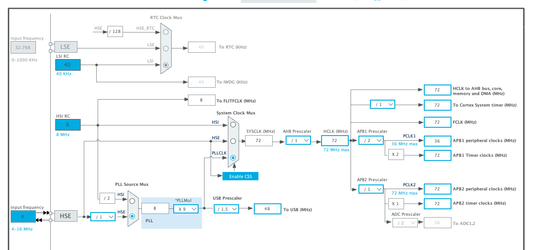

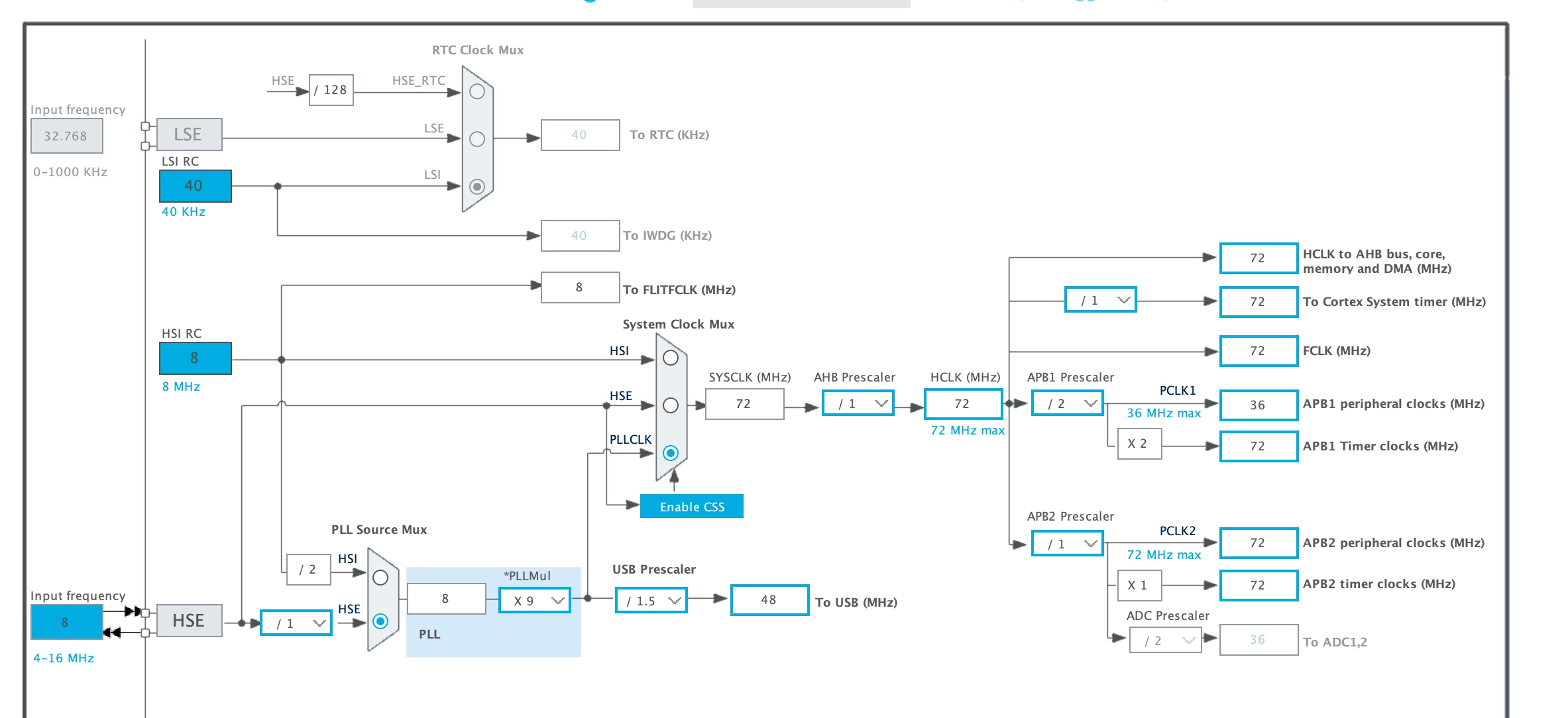

Clock configuration

Even something as “lowly” as stm32f1 does not guarantee cycle-by-cycle timing accuracy. Where there are things like FLASH accelarators and multiple clocks in a system, precise timing becomes unpredictable, particularly if you have other things going on such as DMA or interrupts.
(I think stm32f0 data sheets, in contrast, do mention cycle-by-cycle predictability).
You could reduce the number of things “going on” by putting your delay code inline rather than as a subroutine call - this will avoid delay-unpredictability associated with the jump and push/pull of PC to/from the stack.
How certain are you of the delay error? Are you using a Is it consistent or only on some cycles? I see you are using HSE but is it a crystal or a lower-accuracy ceramic resonator?
You do not go into why timing is so critical for your application. But if it is, you might be better off using DMA driven by a timer to pump your pre-processed pattern to the BSRR register.

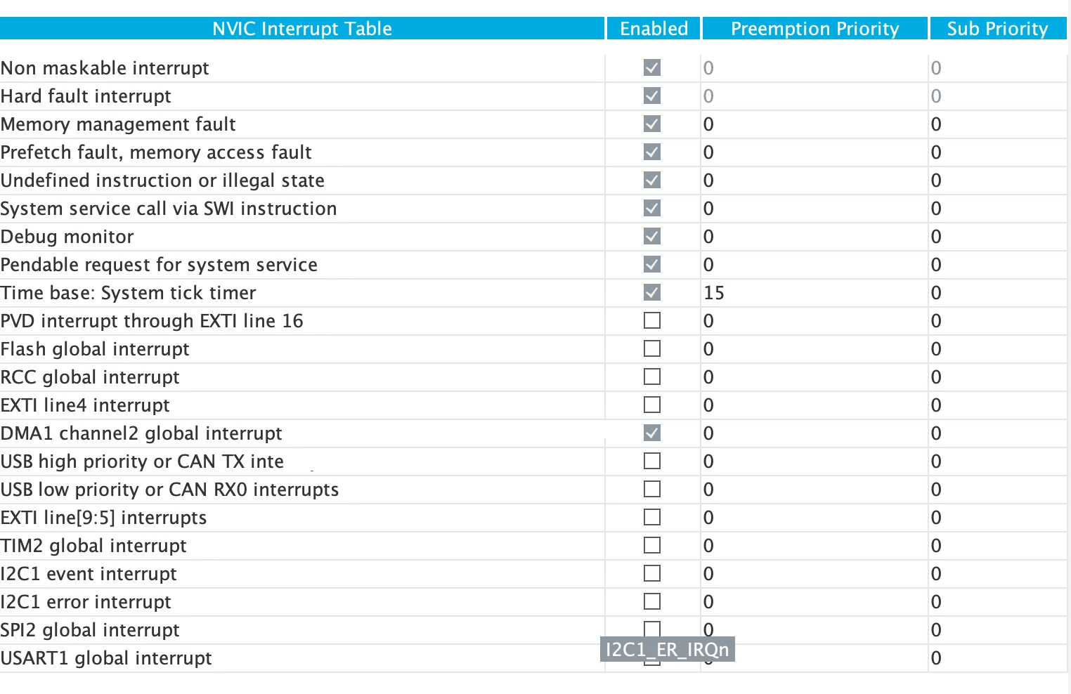

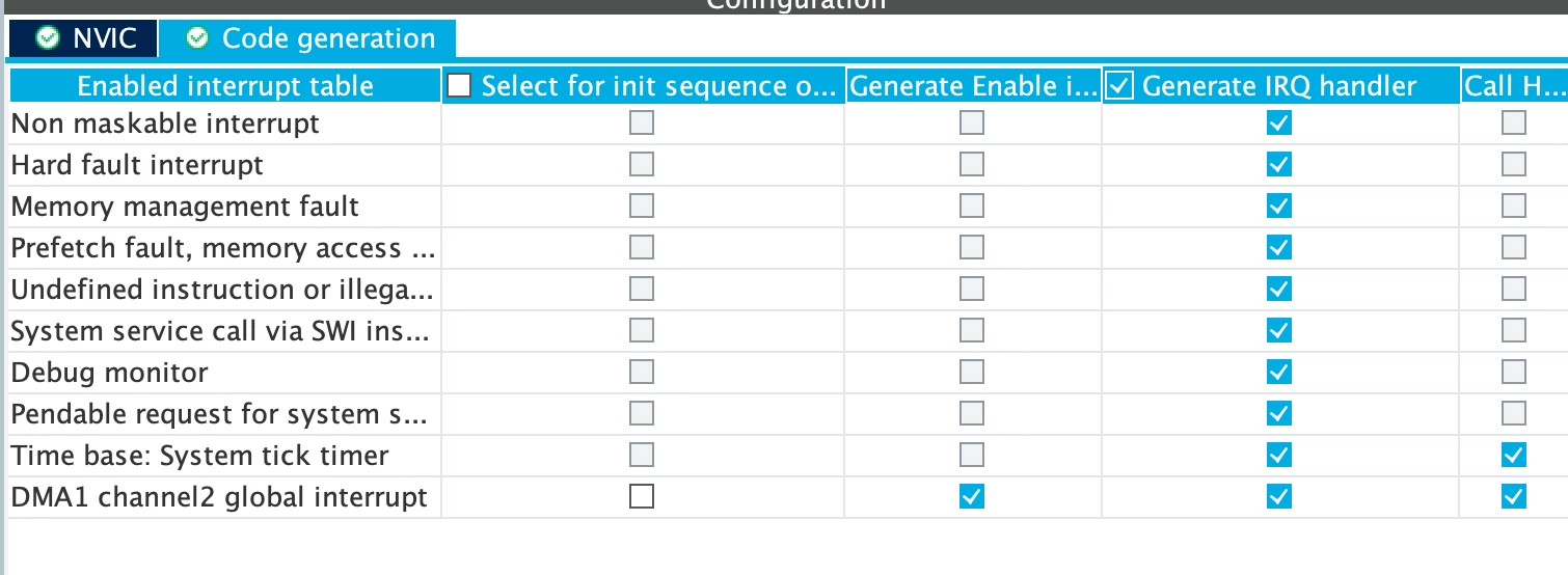

This is the view NVIC in CubeMX,
Does it change something to uncheck these ?

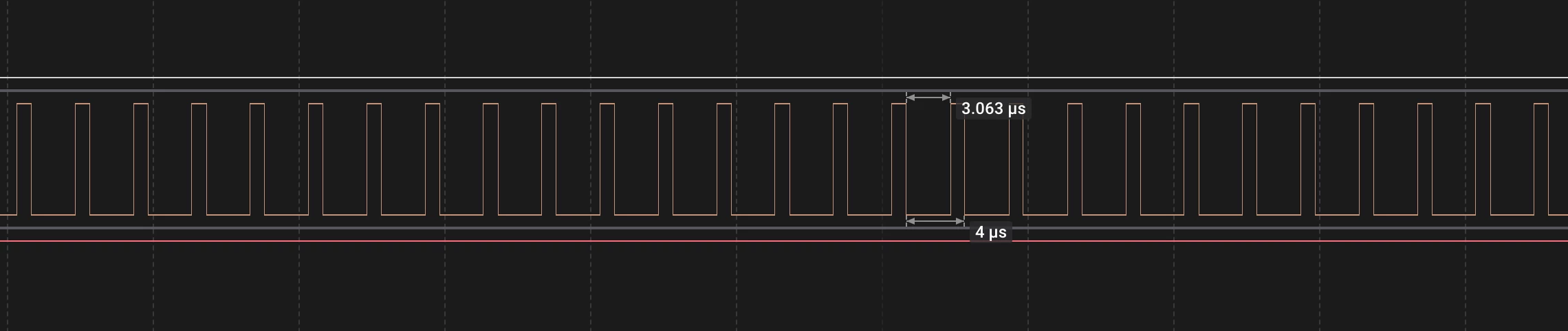

Frame should all be 1us High and 3us low, and I still have glitches...
unsigned_char_array
Lead III
May 13, 2024
I don't see any glitches in your screenshot.
Timing also looks good. The imperfections be an issue with synchronization between the logic analyzer and the microcontroller. Try a logic analyzer with a higher clock and you might see even better timing. Clock dither of the MCU and/or the logic analyzer can also be a factor. Rise time can also be a factor in imperfect measuring of pulse widths.
You say your logic analyzer is clocked at 24MHz, but that would make 3.063us about 73.512 clock cycles of your logic analyzer (or exactly 73.5 cycles and the 3.063 is a rounded number). So that cannot be correct. Does it sample at both edges of the clock? So 48 MSamples/second?

I have done sampling at different logic analyser speed rate and the pulse timing is not right. I have a comparison with an ATMEGA328P.
The issue is that I have 402 bytes per data stream to be sent, it means 402*8*4 us period = 12 864 us for a data sector.
When I have 0.063 us shift time to time, I can have more than 1 bit or 2 shift in the end and data corruption with the 2 byte XOR CRC send at the end of the transfer.
