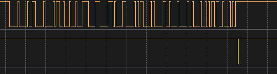

I am using two STM32H723ZGT communicating via FDCAN2 instance (FDCAN, no bit rate switch, 12500 bit/s). Both controller use the same FDCAN initialization code, but different filter IDs.
As shown below, the message is transfered on receiver CAN_Rx (upper trace) and acknowledged on sender CAN_Rx (lower trace), but neither the HAL_FDCAN_RxFifo0Callback() nor HAL_FDCAN_RxFifo1Callback() is triggered. When the receiver is shut down, the ackowledge disapears, so the message seems stuck in the the CAN peripherial.
FDCAN message
CAN instance 1 (CAN2.0) is used for communication with other periperhial devices an works as expected.
What am I missing?
Thanks in advance!

The CAN bus driver provides the differential bus signal, the power to send longer distances and sharpens the received signals.
There would be either a CAN error on the sender side (not observed in any mentioned case) or no CAN ACK on the receiver side (also not observed in any case).
The used 10$ logic anlayser used to provide the shown logs shows clear signals in all cases (so the physical layer is OK) and is able to read and display the send values as the ID/data in a correct way.
Just changing the FilterID2 and global filter as in case 1 and case 2 provides this issue of no interrupt/callback.

so i relay just need the right filter setting for FDCAN Extended ID Filter one ID with one mask.
As playing around with the code shows, that using
canFilterConfig.IdType = FDCAN_EXTENDED_ID; // extended ID
canFilterConfig.FilterType = FDCAN_FILTER_MASK; // second ID is the mask
canFilterConfig.FilterID1 = own_address; // set the CAN ID to be filtered
canFilterConfig.FilterID2 = 0; // mask: 0 => accept all messages
with
HAL_FDCAN_ConfigGlobalFilter(&hfdcan2,
FDCAN_REJECT,
FDCAN_REJECT,
FDCAN_FILTER_REMOTE,
FDCAN_FILTER_REMOTE);
rejects everything, even the matching frames, which is not the way HAL_FDCAN_ConfigGlobalFilter suposed to work. But I have to call HAL_FDCAN_ConfigGlobalFilter() otherwise it dosen't work either ...
