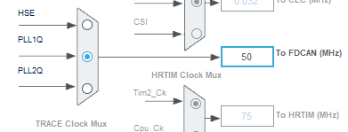

I’m working on a CAN FD project using the STM32H753VIT6 and facing a limitation with data phase bitrate while using Bit Rate Switching (BRS).
My Setup:
  • Controller: STM32H753VIT6
  • FDCAN clock source: PLL1Q
  • PLL1Q output: 40 MHz
  • Frame format: CAN FD with BRS (FDCAN_FRAME_FD_BRS)
  • Nominal (arbitration) bitrate: 1 Mbps
  • Target data bitrate: 2 Mbps or higher
     Problem:
    Despite the configuration, I'm not able to achieve more than ~1.92 Mbps on the data phase. Even when I reduce the number of time quanta or adjust prescalers, the speed does not increase beyond this limit.

Did you activate the delay compensation?:
    * Configure and enable Tx Delay Compensation, required for BRS mode.
    * TdcOffset default recommended value: DataTimeSeg1 * DataPrescaler
    * TdcFilter default recommended value: 0
  if (HAL_FDCAN_ConfigTxDelayCompensation(&hfdcan1, (hfdcan1.Init.DataPrescaler * hfdcan1.Init.DataTimeSeg1), 0U) != HAL_OK)
    Error_Handler();
  if (HAL_FDCAN_EnableTxDelayCompensation(&hfdcan1) != HAL_OK)
    Error_Handler();
Please refer to this Github link linked to this article: STM32 FDCAN running at 8 Mb/s on NUCLEO boards

I don't think there is a limitation 40Mhz vs bitrate > 2Mb/s
Refer to this article: STM32 FDCAN running at 8 Mb/s on NUCLEO boards on which we showed that we can reach 8Mb/s in data phase.
Check also your transceiver bandwidth.
Meanwhile refer to this article: FAQ: Fixing STM32 FDCAN communication disruptions - APB bus, kernel, and time quanta clocks and check if you are in the same situation

Were you able to achieve the target bitrate in Loopback mode?
No, I did not measure the actual bitrate during the external loopback test. I used that mode only to verify the basic communication functionality. Without confirming the exact timing parameters, I proceeded to normal mode, where I am currently testing the communication between two transceivers on the same STM32H753 device. Specifically, I am transmitting from FDCAN1 and receiving on FDCAN2, and then vice versa.
My primary goal is to evaluate the maximum achievable data rate in a real physical setup using CAN FD with Bit Rate Switching (BRS). I have configured PLL1Q at 50 MHz (the max supported for FDCAN on this device), and I am using 64-byte payloads with proper timing configurations.
Could you please guide me on:
  • The best practices for achieving and validating the maximumFDCAN speed on STM32H7?
  • How to accurately measure and verify the bitrate during transmission.
Please test the loopback mode before to proceed ..
Sure, I will test the loopback mode before proceeding. Just to confirm, which loopback mode would be more suitable in my case — internal loopback or external loopback?
External loopback with the same clock and CAN configs and probe CAN_Tx

I think You have set the Data baudrate wrong. If You have set the FDCAN Clock to 50MHz then Your setup:
  hfdcan1.Init.NominalPrescaler = 1;
  hfdcan1.Init.NominalSyncJumpWidth = 4;
  hfdcan1.Init.NominalTimeSeg1 = 86;
  hfdcan1.Init.NominalTimeSeg2 = 13;
  hfdcan1.Init.DataPrescaler = 1;
  hfdcan1.Init.DataSyncJumpWidth = 2;
  hfdcan1.Init.DataTimeSeg1 = 10;
  hfdcan1.Init.DataTimeSeg2 = 2;
will result in:
Nominal Bitrate: 50e6/(1+86+13) = 500e3 (500kBit)
Data Bitrate: 50e6/(1+10+2) = 3.8462e6(!)
if You want 500KBit/2Mbit You have to cange the Data segment's (for example 20 and 4)
i already set this with 50 MHz. but I don't get more than 1.92 mbps"
