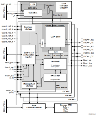

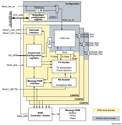

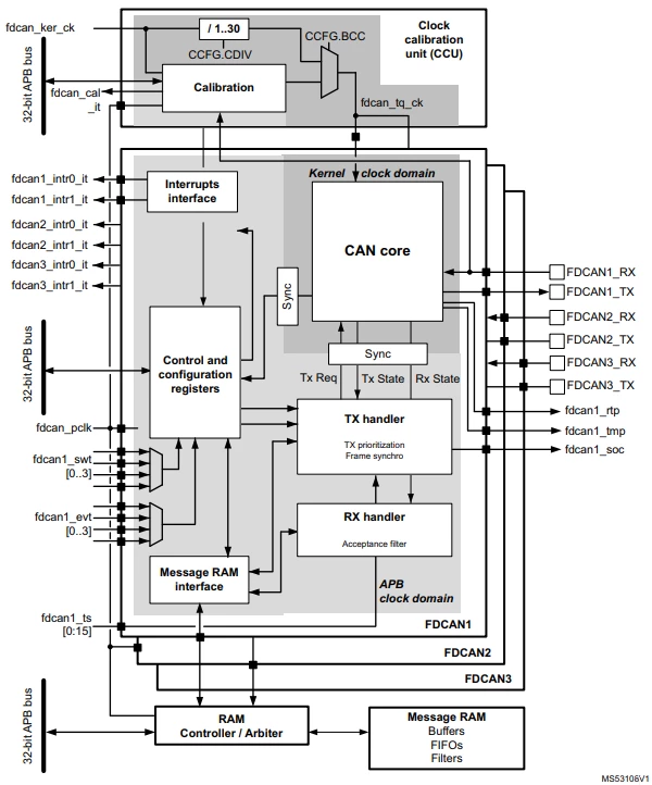

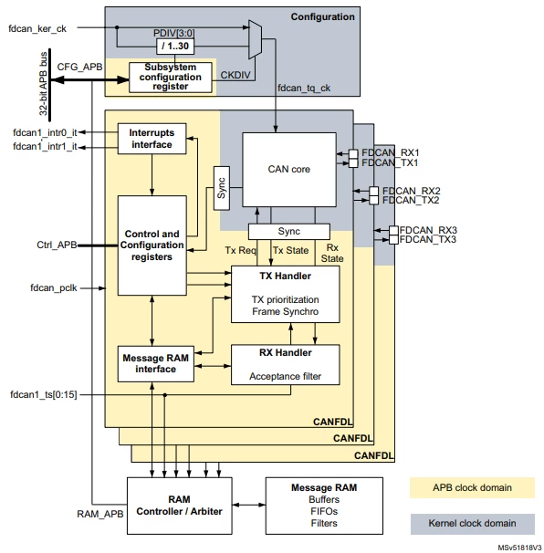

3. FDCAN subsystem block diagram
STM32N6, STM32H7
(except STM32H7RS)
STM32L5, STM32U3, STM32U5, STM32C092, STM32G0, STM32G4, STM32H5, STM32H7RS
2024-10-14 13_44_14-STM32H723_733, STM32H725_735 and STM32H730 Value line advanced Arm®-based 32-bit.png 2024-10-14 13_45_02-STM32G4 series advanced Arm_Sup_®__Sup_-based 32-bit MCUs - Reference manual and.png
The two block diagrams above are extracts respectively of the reference manual of STM32H72x/3x (RM0468) and of the reference manual of the STM32G4 (RM0440).
They display both 3 FDCAN units and a common block on the top. The clock domains, APB and kernel, are displayed with different colors: light and dark gray, or light yellow and gray.

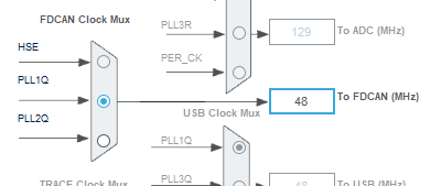

The FDCAN peripheral is connected to the APB1 peripheral bus (refer to the MCU block diagram in the datasheet, generally figure 1). In STM32CubeMX, the FDCAN peripheral clock fdcan_pclk is the APB1 peripheral bus clock as shown in the image below.
The kernel clock fdcan_ker_ck is delivered through a multiplexer allowing to choose among several sources.

4. FDCAN time quanta clock
The FDCAN cores are clocked by a common FDCAN time quanta clock fdcan_tq_ck that is used to define the baud rate of the communication channel.
As shown on the block diagram, this clock is generated from the kernel clock as follows:
fdcan_tq-ck   =   fdcan_ker_ck / DIV
Depending on the STM32 series, the divider is defined by the CDIV[0..3] bits in the FDCAN_CCU_CCFG register (STM32H7) or by the PDIV[0..3] bits in the FDCAN_CKDIV register (for other STM32 series).
The value by default is DIV = 1. When necessary, the divider can be modified to comply with the rule given above between the time quanta clock and the APB clock (fdcan_tq_ck ≤ fdcan_pclk).
