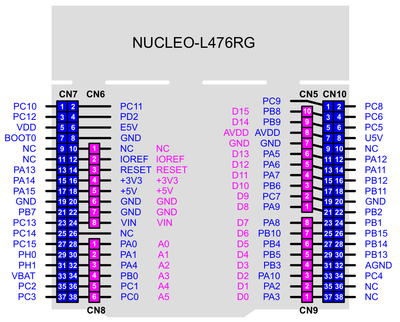

> Only CN7 And CN10 are connected With The Bread-Board.
This is the problem. Arbitrarily shorting pins to the one beside it is not good. Note that CN9 and CN10 share connections and that some 5V power pins are on there.
In particular, connecting AVDD and U5V is likely to kill the chip but maybe you'll get lucky.

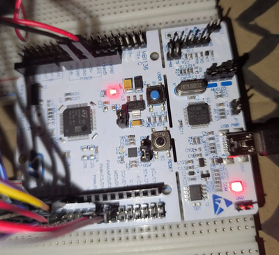

Should just work. CN2 jumpers need to be installed. CN4 should be empty. JP5 should be on U5V.
Did it ever work?
Is the only cable connected the USB?
Is it on a non-conductive surface?
Using STM32CubeProgrammer to connect is best. ST-Link Utility has been deprecated for many years.

Heres A Screenshot Of the Jumpers. The STM32 Is on Breadboard.
- It Did Never Work for Me.
- It's First Time Flashing A Code (That's what Not Working)
- The Only Connected Cable Is the USB (3,3V) .
- The Surface Which Everything Is on Should be Fine :)
- JP5 on U5V.
- CN4 Is now Empty.

Like, plugged into the breadboard? Definitely don't want that. That can certainly damage things as rows of a breadboard are connected. Could have already killed it.
I'd place it on a nonconductive surface, by itself, only hooked up only to the USB cable.

CN9 And CN8 is Not connected With The Bread-Board.
So It will definetly Not Damage Anything !
Im Not Sure how placing it on a non Conductive surface is going To Help me With The Bug.
Looking Forward for your answer.
PS: I will place IT on my wooden table and Test It :)
Maybe you are right and some little Things are interfering With the STM32 resulting in being unable to flash.
Paulo1114
Lmfao I am ***ing retarted It's now doing something. It's still red text but One Step Further! Hell Yeah I think the Chip is still Alive Thank God phewwwww....
I understand your Point now. This Is my very first build :D
