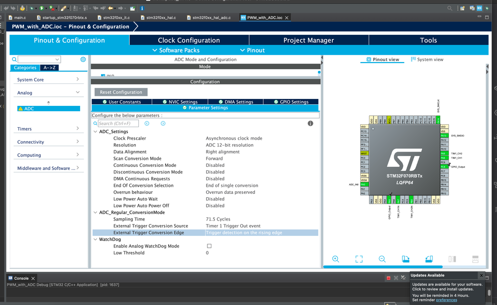

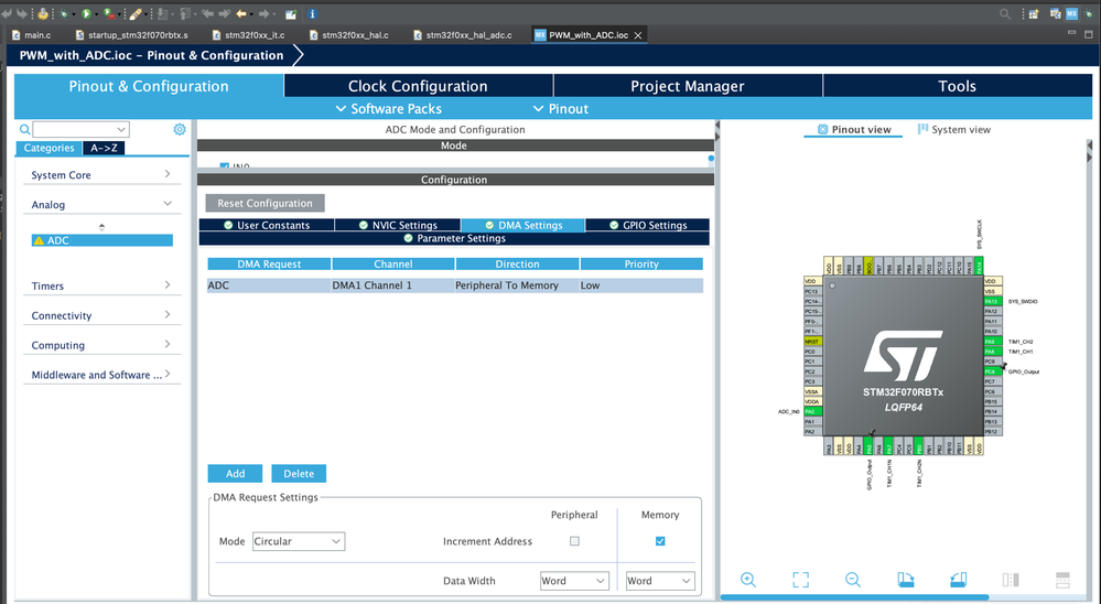

‎2024-05-04 7:19 PM - edited ‎2024-05-04 7:32 PM
What does " mean don't start DMA 2x "?
I turned of all you said but not sampling ADC
I have configured as follows
In DMA data width i tried Half word also

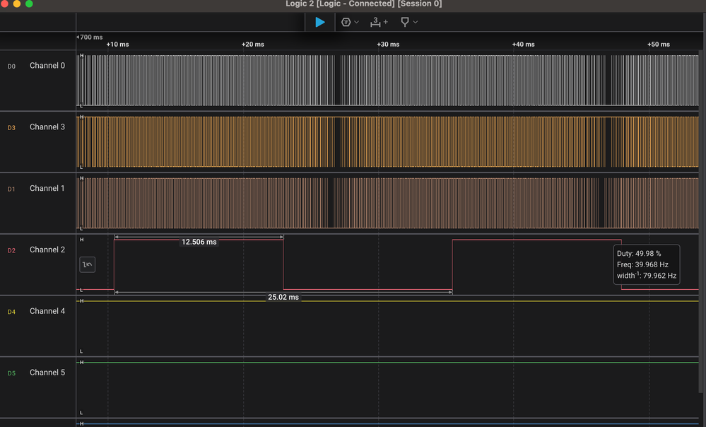

‎2024-05-07 12:35 AM - edited ‎2024-05-07 12:58 AM
I am not started DMA twice
Am not gettinng output
void HAL_ADC_ConvCpltCallback(ADC_HandleTypeDef* hadc)
HAL_GPIO_TogglePin(GPIOC, GPIO_PIN_8);
what will be the problem ?
hadc.Instance = ADC1;
hadc.Init.ClockPrescaler = ADC_CLOCK_ASYNC_DIV1;
hadc.Init.Resolution = ADC_RESOLUTION_12B;
hadc.Init.DataAlign = ADC_DATAALIGN_RIGHT;
hadc.Init.ScanConvMode = ADC_SCAN_DIRECTION_FORWARD;
hadc.Init.EOCSelection = ADC_EOC_SINGLE_CONV;
hadc.Init.LowPowerAutoWait = DISABLE;
hadc.Init.LowPowerAutoPowerOff = DISABLE;
hadc.Init.ContinuousConvMode = DISABLE;
hadc.Init.DiscontinuousConvMode = DISABLE;
hadc.Init.ExternalTrigConv = ADC_EXTERNALTRIGCONV_T1_TRGO;
hadc.Init.ExternalTrigConvEdge = ADC_EXTERNALTRIGCONVEDGE_RISING;
hadc.Init.DMAContinuousRequests = DISABLE;
hadc.Init.Overrun = ADC_OVR_DATA_PRESERVED;

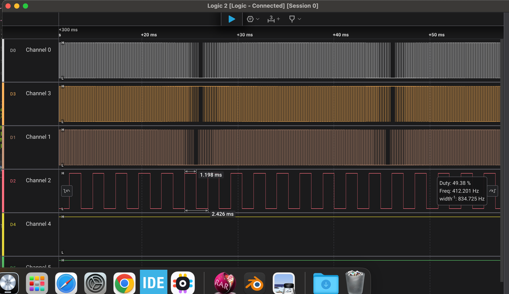

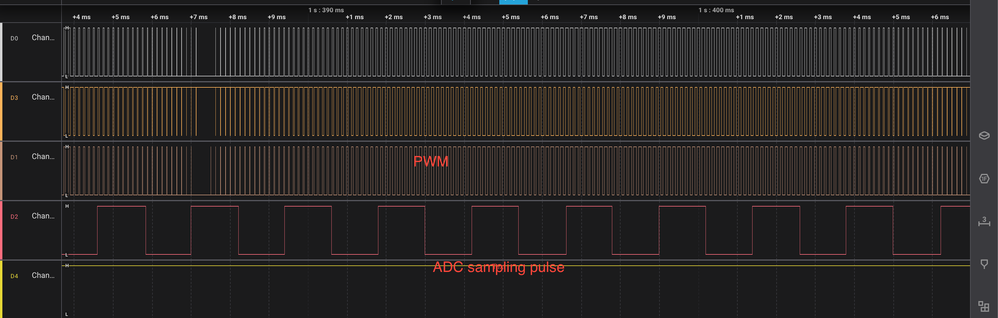

When I enable DMA contnious request the ADC is sample some of frquency as follows 12.506 ms second sample
when i use conntinus DMA request + continous Conversion the following sampling getting
Please help me correct it ?
