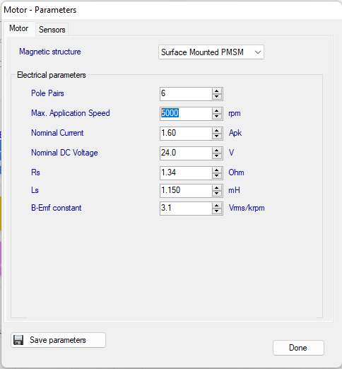

Hello
I updated the motor parameters as per the motor's datasheet. Both in the motor workbench as well as checked the appropriate header files. All the information and specs are correctly loaded in the IDE.
Here is the motor description: https://lin-docs.s3.us-west-2.amazonaws.com/datasheets/external/bldc/BL17E19-01D-03RO.pdf
However, the error I get is startup failure. The code flashes correctly in the MCU but the motor just hums and runs for almost 1-2 seconds, and stops and shows failure. Even when I modify the code to run it using the MC_StartMotor1(); command.

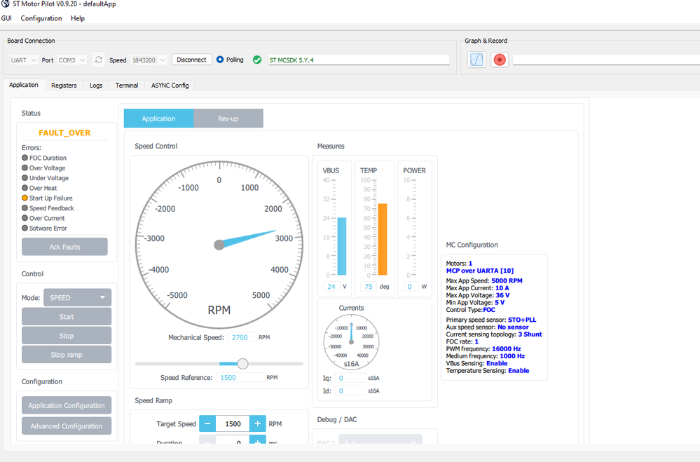

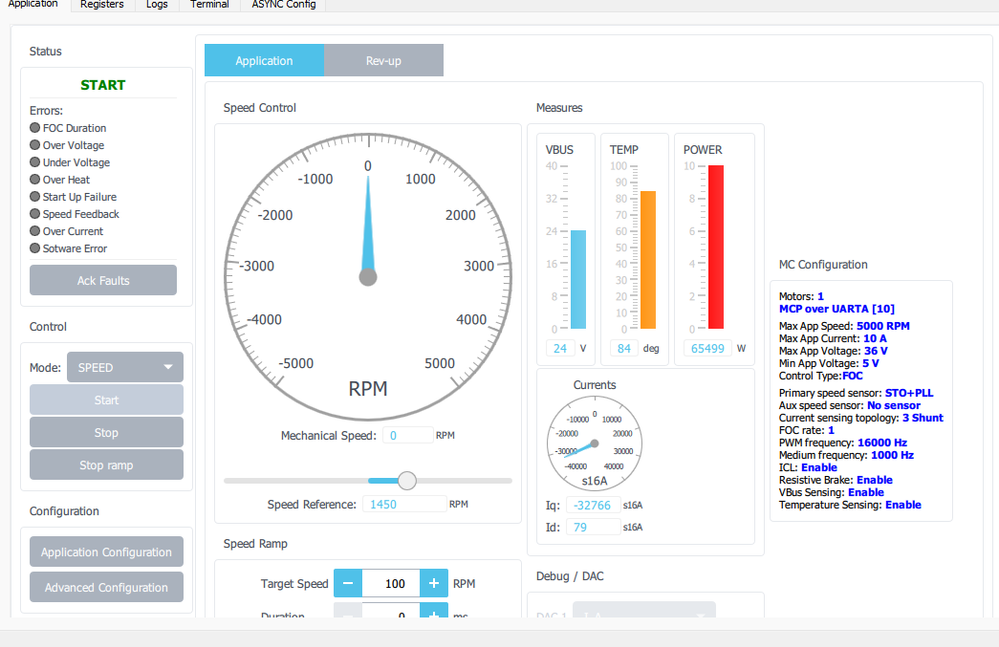

AChha.1
AChha.1Author
August 20, 2022
Hello
Here is an update:
Whenever I run the motor using the motor profiler tool, the following happens.
You can see the power measure is off the chart up to 65kW. I don't think that should be correct. But I don't understand why this happens.
Regards
Anirudh

GMA
August 22, 2022
A short remark, it is mentioned in Motor specification document "Pole Number 6", I assume that it means 3 Pole Pairs...
In Motor Setting WorkBench, "Pole Pairs" is set to 6.
Did you try with 3?

AChha.1
AChha.1Author
August 22, 2022
Hello, I tried using 3 pole pairs, and I get the same error - Startup failure. I think I did that before as well because I was confused about the specs too but I did it again and it throws the same error.
Regards
Anirudh
Edit: The only difference is that when I select 3 pole pairs, it seems to spin more aggressively as it starts but then again the humming and full stop. Startup failure.
However, thank you for pointing that out. I did check the pole pairs manually, by shorting the two phases and I could feel 18 bumps/clicks.
18 --> 3 phases = 6 poles = 3 pole pairs.
My understanding is correct, right?

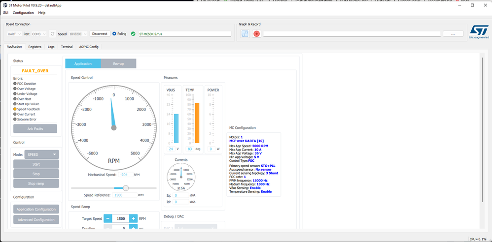

Update:
I write the following code inside the while loop:
/* USER CODE BEGIN 3 */
	 MC_ProgramSpeedRampMotor1(3000/6,1000);//Set the speed to 3000
	 MC_StartMotor1();//Motor running
	 HAL_Delay(10000);//Delay 10S
However, the motor still acts the same. Loud rev-up, little spin, humming and full stop. I attached a video of this as well.
Thanks!

GMA
August 24, 2022
The remarks about F446 topic seems to be also relevant for F401 as both boards share same schematic... Other connections between F401 and IHM16 have to be also verified. I will come back to you...
Best regards.

GMA
GMABest answer
August 24, 2022
Please find attached an example stmcx used to run a test with same configuration F401/IHM16 but with a different motor. I made the same modifications as on F446 forum topic:
  • All ADC input have to be checked in "Analog Input and Protection" box, pin map for "Phase current feedback", "Bus voltage feedback" and "Temperature feedback" tabs.
  • I removed IHM16 R41 resistance.
  • And I also changed the Drive Management / Start-up parameters Profile from "Advanced customized" to "Basic".
Hope it helps you.

AChha.1
AChha.1Author
August 31, 2022
Hello
Do I need to cut the pin CN10-18 on the Nucleo? Or should it work without doing that and just loading the file you provided?
Update:
I got it and am able to control the motor perfectly. Thank you so much for your help! I appreciate it.
On the issue you helped me with, is there documentation that provides information about the boards affected by this difference in their pin layouts? I feel that such things should've been mentioned in the IHM16M1 User Manual, which is just a generic tutorial. It says that the driver is compatible with F401RE but doesn't tell how to make it work.
