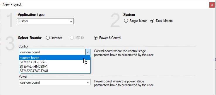

Hello, I have a follow-up question regarding this. What would be the steps briefly if I wanted to control multiple motors?
From my understanding, I need to add relevant functions for Motor2 in the "mc_api.c" file inside the IDE. Is this correct?
Also, the "mc_api.c" mentions that it can only cope with 2 motors. How do I control 3 motors?
It would be great if you could answer these questions.
Regards
Anirudh
GMA
Using WB5.4.8 e.g., you can choose Dual Motor configuration. You will have a set of available control boards for that purpose:
0693W00000SujgzQAB.pngGenerating the code, the dual motor api will be visible in mc_api.c.
3 motors are not supported by the workbench for the moment.
Best regards.
