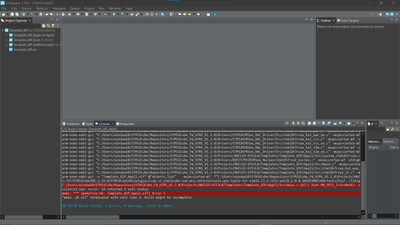

I imported the Template_XIP project into STM32CubeIDE. The project compiled, uploaded to the board successfully, and I was able to debug without any issues. However, after attempting to enable SPI1 using both STM32CubeIDE and STM32CubeMX, and generating code based on those settings, I encountered the following build error in the Template_XIP_Appli project:
/Users/xxxxxx/STM32Cube/Repository/STM32Cube_FW_H7RS_V1.2.0/Projects/NUCLEO-H7S3L8/Templates/Template_XIP/Appli/Src/main.c:201:(.text.MX_SPI1_Init+0x96): undefined reference to `HAL_SPI_Init'
/Users/xxxxxx/STM32Cube/Repository/STM32Cube_FW_H7RS_V1.2.0/Projects/NUCLEO-H7S3L8/Templates/Template_XIP/Appli/Src/stm32h7rsxx_it.c:253:(.text.SPI1_IRQHandler+0x6): undefined reference to `HAL_SPI_IRQHandler'
make: *** [makefile:66: Template_XIP_Appli.elf] Error 1

From my understanding, HAL_SPI_Init and related functions should be automatically generated when enabling SPI1 in STM32CubeMX/IDE. I’ve tried the following:
  • Regenerating code multiple times
  • Running both STM32CubeIDE and STM32CubeMX as administrator
  • Verifying project settings and middleware configurations
  • Searching extensively across ST documentation, forums, and community discussions
Unfortunately, I’ve found no solution after two full days of trying. It's unclear whether this is a problem with the project template, the HAL package, or the toolchain integration.
I would deeply appreciate expert guidance on:
  1. How to properly enable and use SPI1 in the Template_XIP_Appli project.
  2. Whether the Nucleo-H7S3L8 board currently supports common peripherals like SPI and I2C in XIP mode.
  3. Why a major company like ST would release a product with documentation and software support in such a fragmented state.
At this point, I’m seriously questioning whether reliable SPI/I2C connectivity is even possible on this board without deep manual intervention. Any clarification or official insights would be extremely helpful.
