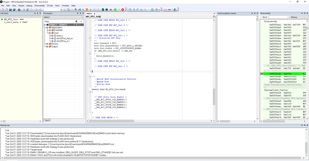

i'm using stm32f103rct.
Use cubemx and just set RCC,and SYS(JTAG, Timebase Systick)
compile with IAR and then download and debug press break.
Hard fault exception
0693W000004KMPxQAO.pnghelp plz

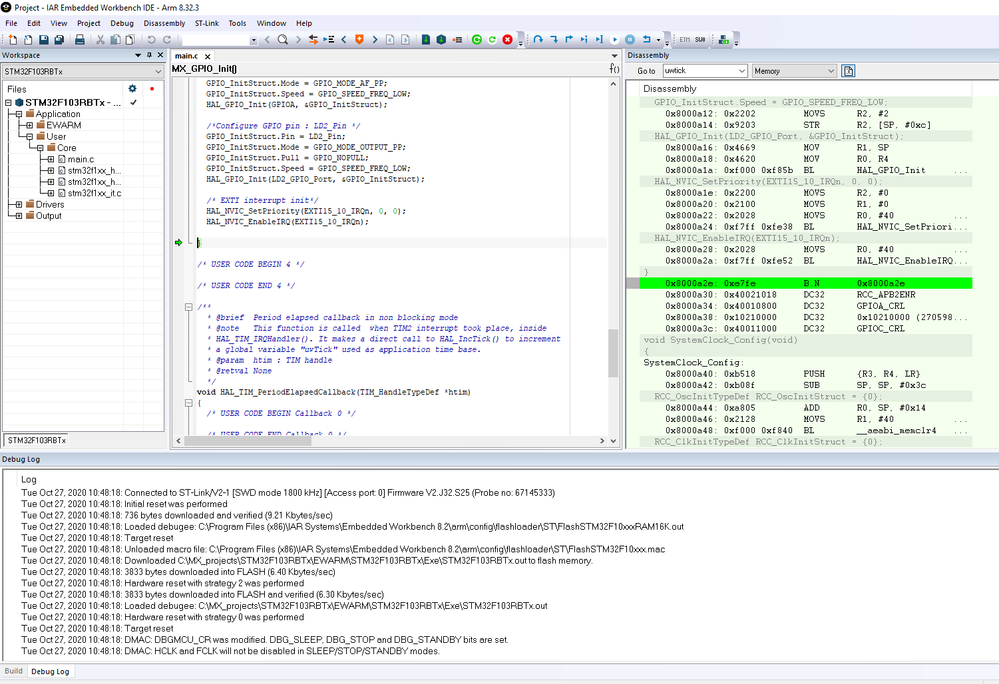

Hi @sjaey.1​
Tested the same scenario by using a Nucleo-F103RB, i had no issue.
0693W0000059R2HQAU.pngBest regards,
Nesrine
Could you please share you .ioc file to check with.

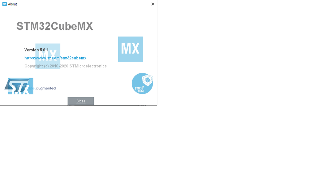

Please specify you STM32CubeMX version.
sjaey.1
0693W0000059RCHQA2.pngVersion 5.6.1
No issue detected when using STM32CubeMX v 6.0.1.
