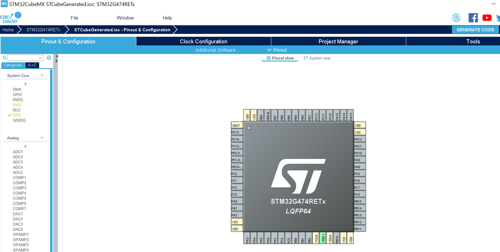

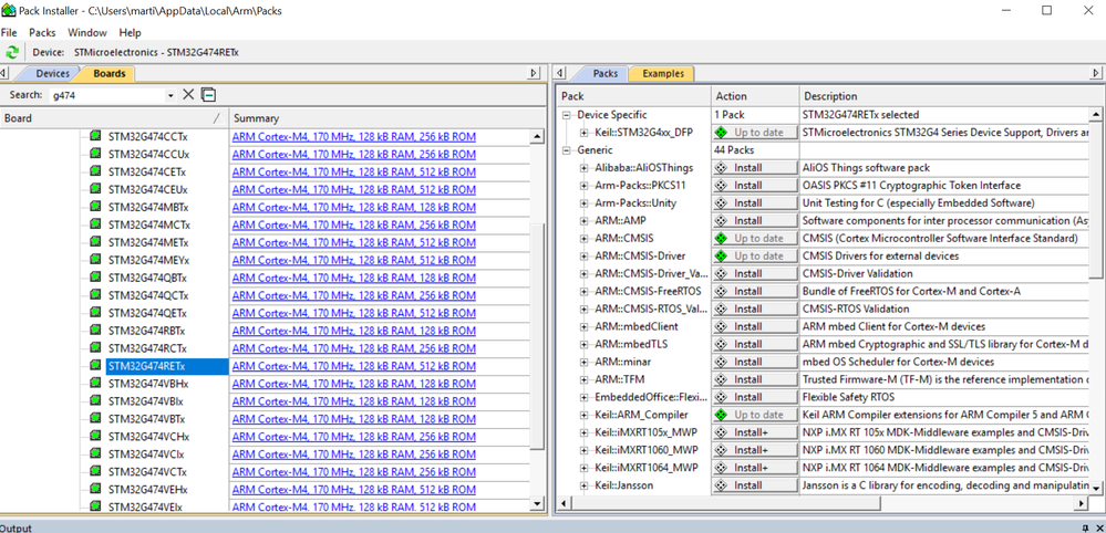

Hi, i'm a beginner and need some help. I bought a nucleo g474 Board and followed 2 startup how tos. Keil + Cubemx. When i produce the initialisation code i always get the error in the stm32g4xx_ll_fmc.c file Does anybody know what im doing wrong?
Thomas1s
C:\Users\marti\AppData\Local\Arm\Packs\Keil\STM32G4xx_DFP\1.1.0\Drivers\STM32G4xx_HAL_Driver\Src\stm32g4xx_ll_fmc.c(176): error: #20: identifier "FMC_NORSRAM_TypeDef" is undefined
 HAL_StatusTypeDef FMC_NORSRAM_Init(FMC_NORSRAM_TypeDef *Device, FMC_NORSRAM_InitTypeDef *Init)
C:\Users\marti\AppData\Local\Arm\Packs\Keil\STM32G4xx_DFP\1.1.0\Drivers\STM32G4xx_HAL_Driver\Src\stm32g4xx_ll_fmc.c(176): error: #20: identifier "FMC_NORSRAM_InitTypeDef" is undefined
C:\Users\marti\AppData\Local\Arm\Packs\Keil\STM32G4xx_DFP\1.1.0\Drivers\STM32G4xx_HAL_Driver\Src\stm32g4xx_ll_fmc.c(201): warning: #223-D: function "__FMC_NORSRAM_DISABLE" declared implicitly
  __FMC_NORSRAM_DISABLE(Device, Init->NSBank);
C:\Users\marti\AppData\Local\Arm\Packs\Keil\STM32G4xx_DFP\1.1.0\Drivers\STM32G4xx_HAL_Driver\Src\stm32g4xx_ll_fmc.c(204): error: #20: identifier "FMC_MEMORY_TYPE_NOR" is undefined
  if (Init->MemoryType == FMC_MEMORY_TYPE_NOR)

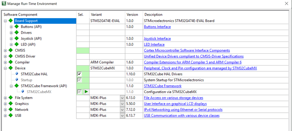

Need to make sure the FMC modules is enabled in stm32g4xx_hal_conf.h
Check also command line defines.
Thomas1s
Hi, thanks to the Input of clive1 i found out that you have to enable the SRAM Module in stm32g4xx_hal_conf.h
/*#define HAL_SRAM_MODULE_ENABLED  */
Seems to be an CUBEMX BUG
Thanks a lot
Thomas

Hello, did you receive the ioc file? I have the same issue in G473 in Keil, where the Cube generated code won't compile in stm32g4xx_ll_fmc.c until I uncomment the line with #define HAL_SRAM_MODULE_ENABLED in the stm32g4xx_hal_conf.h header.

Hello everyone, I return to the topic. Has anyone found the source of this issue?
I am creating the project from scratch in Keil, then I add the STMCubeMx from the RTE administrator, without initializing any peripherals or modules, I just click on "Generate code". And I have the same issue with HAL_SRAM_MODULE_ENABLED.
