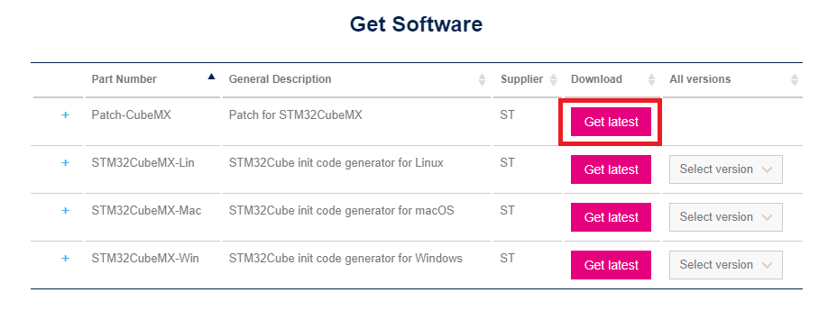

When FreeRTOS is enabled in STM32CubeMx for STM32F4 MCUs, the generated code should create the tasks already configured by the user.
In this context, a regression was detected in the latest STM32CubeMX version (6.7.0) and only with the STM32F4 series of MCUs.
As a result, we propose this temporary solution while the fix is implemented in a future release. To put it in place, follow the step described down below. And please if you are not using an F4 we advise you to not apply this solution.

‎2022-12-20 3:53 PM
The download links doesn't download anything and just opens the CubeMX page. If you mean that a patch v6.7.1 must be downloaded, just say it clearly.
‎2023-01-08 12:58 PM
Dear Piranha,
You are right, the link bring to STM32CubeMX page.
Once on it, you need to download the patch as indicated below.
‎2023-01-08 4:45 PM
@Jerome B​ , the problem is that the topic author didn't mention neither the "patch", nor the "v6.7.1" anywhere at all. Instead he gave a four separate links, which are actually all the same and do not point to the files to be downloaded. And, if the links are not to the specific files, there is no need for them to be so long with million parameters. They can be just like this:
https://www.st.com/en/development-tools/stm32cubemx.html
I personally don't need this "captain obvious" level help for "especially gifted ones" on how to scroll a webpage and click the red buttons. Now, if you could fire the completely incompetent HAL/Cube team and hire a competent developers, that would be something!
