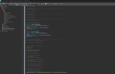

We have recently updated our STM32CubeIDE to a newer version (1.19.0, from 1.18.0) and we have encountered an issue when using CubeMX. Whenever we launch the code generation some code sections in the file 'app_freertos.c' get duplicated. For example:
/* Definitions for defaultTask */
osThreadId_t defaultTaskHandle;
const osThreadAttr_t defaultTask_attributes = {
  .name = "defaultTask",
  .priority = (osPriority_t) osPriorityNormal,
  .stack_size = 1024 * 4
/* Definitions for i2c_Task */
osThreadId_t i2c_TaskHandle;
const osThreadAttr_t i2c_Task_attributes = {
  .name = "i2c_Task",
  .priority = (osPriority_t) osPriorityAboveNormal,
  .stack_size = 512 * 4
will become:
  .name = "i2c_Task",
  .name = "i2c_Task",
and the same goes for the assignment of the task handles, as well as for the implementations of the task start functions. Other files like 'main.c' are not affected by this it seems. However I cannot confirm if the above mentioned file is the only one.

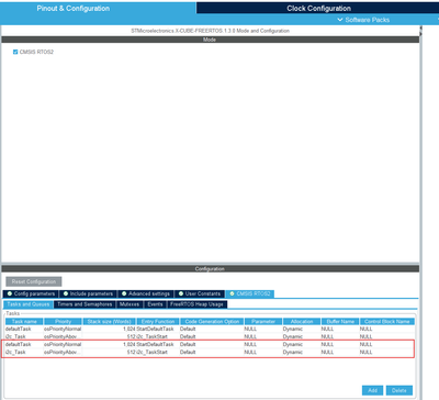

Katzenfutterdose
Hello @Mahmoud Ben Romdhane
Thank you for your reply! I have attached the .ioc file of the project below. I forgot to mention in the original post, that we also migrated to the newer software package versions after we were prompted by the IDE after the update.

Katzenfutterdose
Your suggestion fixed the issue. To be honest I didn't think to look at the FreeRTOS config inside of CubeMX as I didn't know it was possible to create two identical tasks in there. I still don't know how they got there in the first place but that doesn't matter now.
