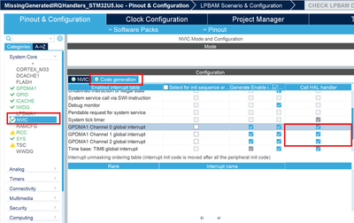

Hello @xlrl
Using your .ioc file, I've been able to generate the code expected:
void GPDMA1_Channel0_IRQHandler(void)
  /* USER CODE BEGIN GPDMA1_Channel0_IRQn 0 */
  /* USER CODE END GPDMA1_Channel0_IRQn 0 */
  HAL_DMA_IRQHandler(&handle_GPDMA1_Channel0);
  /* USER CODE BEGIN GPDMA1_Channel0_IRQn 1 */
  /* USER CODE END GPDMA1_Channel0_IRQn 1 */
I've just made a change on the .ioc file setting the "Call HAL handler" option for this interrupt:

Hello @xlrl
Best Regards.
STTwo-32
