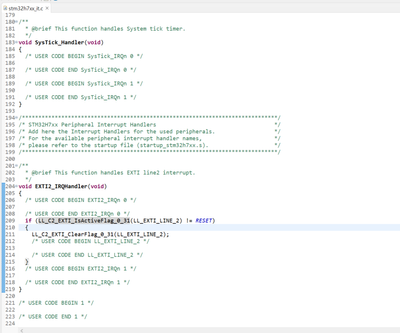

Generating the EXTI2_IRQHandler for the M4 core:
void EXTI2_IRQHandler(void) { /* USER CODE BEGIN EXTI2_IRQn 0 */ /* USER CODE END EXTI2_IRQn 0 */ if (LL_EXTI_IsActiveFlag_0_31(LL_EXTI_LINE_2) != RESET) { LL_EXTI_ClearFlag_0_31(LL_EXTI_LINE_2); /* USER CODE BEGIN LL_EXTI_LINE_2 */ /* USER CODE END LL_EXTI_LINE_2 */ } /* USER CODE BEGIN EXTI2_IRQn 1 */ /* USER CODE END EXTI2_IRQn 1 */ }
The generated code uses LL_EXTI_IsActiveFlag_0_31 and LL_C_EXTI_ClearFlag_0_31 instead of LL_C2_EXTI_IsActiveFlag_0_31 and LL_C2_EXTI_ClearFlag_0_31 for CORE2.

Hello @peterdonchev
Actually I tried to reproduce the issue mentioned above but I found that CubeMX 6.13.0 works just fine and this is my generated code :
I am sharing my IOC with you to double check my configuration.
I would appreciate it if you could provide your IOC to continue the investigation.

p.s.: I migrated your project to STM32Cube FW_H7 V1.12.1 and the problem reappeared!
Hello @peterdonchev
This issue has been raised to the development team to correct this behavior internal ticket number 200413 .

Hello @peterdonchev
The issue is fixed in the latest release of the STM32CubeMX (6.14.0).
