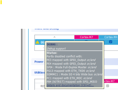

bramble
Senior
June 16, 2025
Hi @mattias norlander ,
Thank you for this info - it seems a sensible change.
I wonder if in the new MX we may be given clearer information about the validity of settings? For example, here's a typical situation were a warning has been raised:
I sometimes find these warnings give sufficient info to know how to resolve the issue. However, they're often false alarms that can be safely ignored, and when they are important I think the clues given in the pop-up are not always very helpful. I'm sure that to implement robust and always perfect warnings is not always easy - but I think that improvements in this area would be widely appreciated.
Thanks

@bramble , I would say that that is a pure CUbeMX issue. I think that reporting this in a separate thread might give it better visibility possibly leading to higher prio to fix. This  thread is more CubeIDE related. Two different dev-teams.

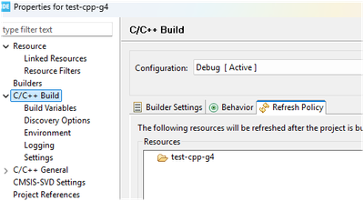

Pavel A.
June 18, 2025
@mattias norlander
We are analyzing how-to update the File explorer after an MX stand-alone code generation has finished...
There was another related request, if you've noticed: how to force refresh of a managed project if a pre-build script changes source files (adds/deletes/renames, tree changes as well).
Eclipse has "Refresh policy" that currently applies at post-build. Looks like a pre-build policy is needed? Or does Eclipse already handle this automatically?
