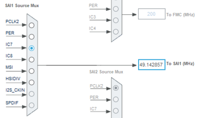

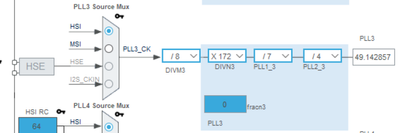

When generating code with CubeMX (Version 6.14.1) for the STM32N657X0 with the following clock configuration for SAI1:

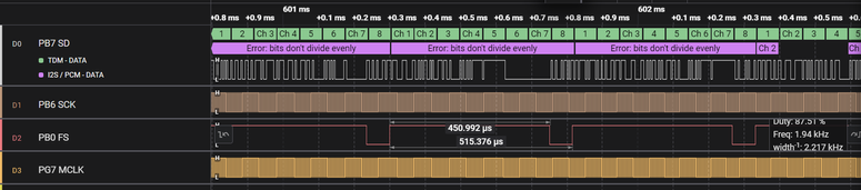

With the above MX configuration and below code, the SAI1 FS is around 2 KHz:
After adding the lines:
PeriphClkInitStruct.ICSelection[RCC_IC7].ClockSelection = RCC_ICCLKSOURCE_PLL3;
PeriphClkInitStruct.ICSelection[RCC_IC7].ClockDivider = 1;
to HAL_SAI_MspInit() in stm32n6xx_hal_msp.c the signals are correctly generated:
