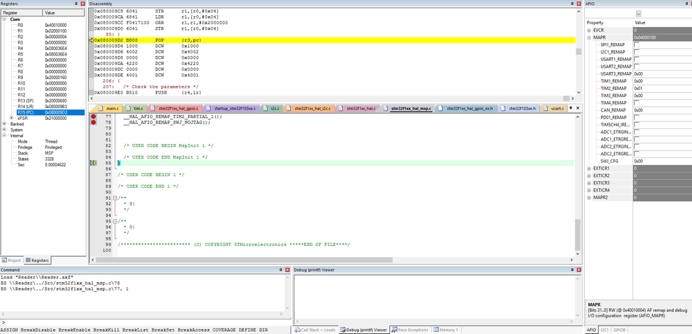

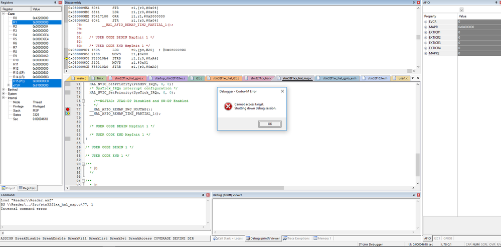

I tried to use bit-banding for the purpose of modifying separate bits in AFIO_MAPR register in following manner:
#define BIT_BAND_PERIPH(REG,BIT_POS) (*(volatile uint8_t*)(PERIPH_BB_BASE+32*((uint32_t)(&(REG))-PERIPH_BASE)+4*((uint32_t)BIT_POS)))
#define __HAL_AFIO_REMAP_TIM2_PARTIAL_1() do{ BIT_BAND_PERIPH(AFIO->MAPR, AFIO_MAPR_TIM2_REMAP_PARTIALREMAP2_Pos) = 0; \
 BIT_BAND_PERIPH(AFIO->MAPR, AFIO_MAPR_TIM2_REMAP_PARTIALREMAP1_Pos) = 1; \
 }while(0U)�?�?�?�?�?�?�?�?�?�?
It works perfect if I place call to this macro before remapping JTAG to SWO pins like this:
However, if I change order of macros invoked, as in case with CubeMX autogenerated code, the error still there:
Modifying macro in following manner didthe trick for me, but it's inflexible solution:
#define __HAL_AFIO_REMAP_TIM2_PARTIAL_1() AFIO->MAPR = 0x02000100;�?
