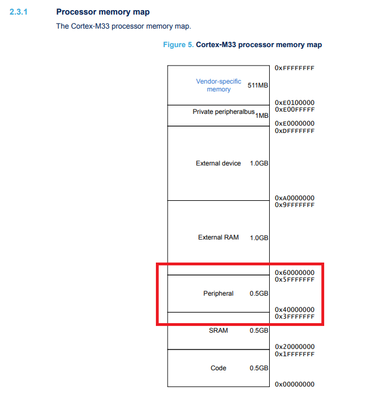

  • The default memory region in STM32U5 defines the complete 0x40000000 - 0x60000000 region as peripherals and therefore device memory
  • BKPSRAM is inside the Peripheral Address range, so the default map puts it as device memory
  • To use BKPSRAM as "normal" memory, the MPU needs to be enabled and its region defined specifically
Indeed.

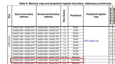

According to the reference manual, BKPSRAM is in the range of:
and according to the programming manual PM0264, Backup SRAM is in the Peripheral memory range address which has a memory attribute: Device:
As said by @waclawek.jan , and according to the CM33 TRM:
https://developer.arm.com/documentation/100230/0100/Programmers-Model/Memory-model/Unaligned-accesses:
So you need to use MPU and configure BKPSRAM memory region of 2K as Normal memory attribute.

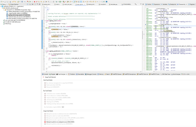

As you can see in the screenshot there is a str to 0x40036452 which leads to an unaligned access hard fault. Which is not present if I compile with -mno-unaligned-access or place the variables in standard SRAM.

At least unaligned access is what the hard fault analyzer states. But ECC might be an issue when initializing the "no load" ram cells with values which are no multiples of its granularity :thinking_face:, that's right.

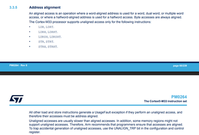

As shown by PM0264the "STR" instruction is supported by the unaligned access.
Well using that specific memory the hardware doesn't seem to agree. But I'll look into the ECC topic.
EDIT: ECC is turned off (flag = 1) in the option bytes and UNALIGN_TRP ist not set.
