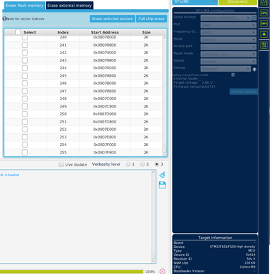

I am using a stm32 F103RCT6 mcu. It has 256 Kb of flash memory. But when i connect it to cube programmer, it shows there are 256 sectors of 2K size which equates to 512 Kb flash.
I was even able to go to that last page and write data to it. so is the linker script generated by HAL wrong?
AScha.3
Nothing wrong here. :)
Just you got a F103 with full flash, 512K.
Reason is: for the purpose of rationalized production only one die is produced , with 512K .
Testing the flash is "expensive" on the chip tester, so short test -> smaller flash tested -> cheaper version.
So you have a chip with 256K flash, tested and 100% working - as you ordered.
And there is more flash on the die, might work fine or not - you didnt pay for tested 512K .
So you can use it, but dont cry, if there is an error....
And linker script is ok, if 256K is used, as you ordered.

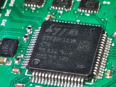

Where did you obtain it?
Are you sure it is genuine?
I ordered it from LCSC. Attached below is the image
You mean here: https://www.lcsc.com/ ?
Not an Authorised Distributor, so there is a risk it's fake.
Maybe this diagnostic can help you identify it ...

but shouldn't CubeIDE CubeProgrammer recognise the chip from its ID, and only report the specified memory sizes ?
Maybe, if different ID is written to chip, but basically is same die for c-d-e flash size:

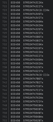

connect a H743ZG  , 1MB flash (but die has 2MB :(
and all are 450 die :
But obviously here something written to the chip, to disable dual core, flash size info, etc.
So i tried using the 2MB flash - and yes, its there - but not tested, as ordered version has 1MB.
