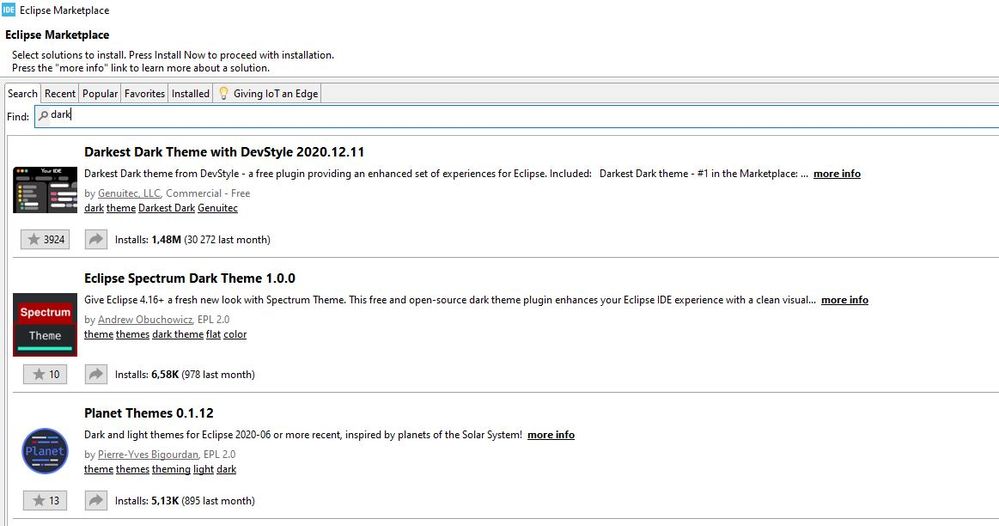

Thanks @EJOHA​ . Look, I'm suspecting right now that the problem is not caused by the Cube IDE update but an eclipse extension called dark theme from dev-style, it is found in the marketplace and I've been using by a long time, but after reinstall the 1.5.0 version of the Cube IDE I installed the eGit extension and the dark theme extension and the IDE started to fail without updating the IDE, it can't found the default editor and opens the files with the default editor of the computer, or may be are both. What is strange to me is that the dark theme extension was added in my Cube IDE installation in july last year, unless the updated the extension and that extensions had a failure too but like I said, right now I have the version 1.5.0 without updates and after install the dark theme extension it started to fail, it can't even find the resources related to the stm32 compilation.

It was mentioned in this post that the problem could have been caused by having installed the "dark theme" plugin.
Please let me know also if you have installed the "dark theme" plugin.

Also have installed "dark theme"
‎2020-12-21 1:54 AM
Just curious. Which dark theme contribution are you relying on. So many available:
‎2020-12-21 1:54 AM
I confirm the same problem. In my case: Windows 10, upgrade from v1.5.0, project imported from file system, no "dark theme" (Enable theming - off)
