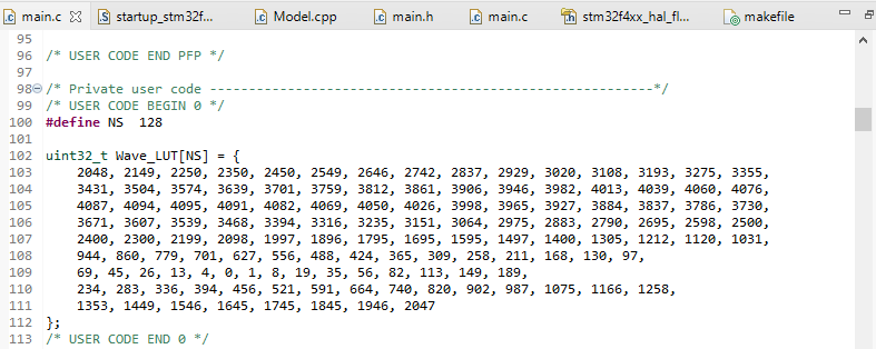

I followed a tutorial on how to generate a SINE wave using DAC and DMA that was really good. Logically it makes sense, you set up the DAC, set it to be triggered by a timer, then set up the DMA channel, set it to circular, and set it to use a table of values. Start the time and the DAC DMA, should work, right? Not working for me unfortunately, no output on the PIN PA4. Here are some screenshots of my CubeMX and a snippet of my MAIN Code:
/* USER CODE BEGIN 0 */
#define NS 128
uint32_t Wave_LUT[NS] = {
  2048, 2149, 2250, 2350, 2450, 2549, 2646, 2742, 2837, 2929, 3020, 3108, 3193, 3275, 3355,
  3431, 3504, 3574, 3639, 3701, 3759, 3812, 3861, 3906, 3946, 3982, 4013, 4039, 4060, 4076,
  4087, 4094, 4095, 4091, 4082, 4069, 4050, 4026, 3998, 3965, 3927, 3884, 3837, 3786, 3730,
  3671, 3607, 3539, 3468, 3394, 3316, 3235, 3151, 3064, 2975, 2883, 2790, 2695, 2598, 2500,
  2400, 2300, 2199, 2098, 1997, 1896, 1795, 1695, 1595, 1497, 1400, 1305, 1212, 1120, 1031,
  944, 860, 779, 701, 627, 556, 488, 424, 365, 309, 258, 211, 168, 130, 97,
  69, 45, 26, 13, 4, 0, 1, 8, 19, 35, 56, 82, 113, 149, 189,
  234, 283, 336, 394, 456, 521, 591, 664, 740, 820, 902, 987, 1075, 1166, 1258,
  1353, 1449, 1546, 1645, 1745, 1845, 1946, 2047
/* USER CODE END 0 */
 * @brief The application entry point.
 * @retval int
int main(void)
 /* USER CODE BEGIN 1 */
HAL_DAC_Start_DMA(&hdac, DAC_CHANNEL_1, (uint32_t*)Wave_LUT, 128, DAC_ALIGN_12B_R);

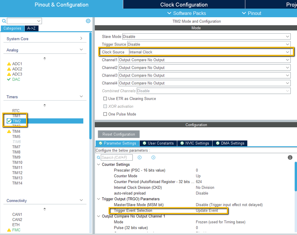

Thanks for the prompt reply TDK and Amel!
I am working with a STM32F469I-Discovery board.
Where are your initialization calls for TIM and DAC?
The CubeMX tool included the calls in Main.c. I'll get some screenshots or code below this reply to reference.

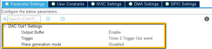

static void MX_DAC_Init(void)
 /* USER CODE BEGIN DAC_Init 0 */
 /* USER CODE END DAC_Init 0 */
 DAC_ChannelConfTypeDef sConfig = {0};
 /* USER CODE BEGIN DAC_Init 1 */
 /* USER CODE END DAC_Init 1 */
 /** DAC Initialization
 hdac.Instance = DAC;
 if (HAL_DAC_Init(&hdac) != HAL_OK)
  Error_Handler();
 /** DAC channel OUT1 config
 sConfig.DAC_Trigger = DAC_TRIGGER_T2_TRGO;
 sConfig.DAC_OutputBuffer = DAC_OUTPUTBUFFER_ENABLE;
 if (HAL_DAC_ConfigChannel(&hdac, &sConfig, DAC_CHANNEL_1) != HAL_OK)
  Error_Handler();
 /* USER CODE BEGIN DAC_Init 2 */
 /* USER CODE END DAC_Init 2 */

static void MX_TIM2_Init(void)
 /* USER CODE BEGIN TIM2_Init 0 */
 /* USER CODE END TIM2_Init 0 */
 TIM_ClockConfigTypeDef sClockSourceConfig = {0};
 TIM_MasterConfigTypeDef sMasterConfig = {0};
 TIM_OC_InitTypeDef sConfigOC = {0};
 /* USER CODE BEGIN TIM2_Init 1 */
 /* USER CODE END TIM2_Init 1 */
 htim2.Instance = TIM2;
 htim2.Init.Prescaler = 0;
 htim2.Init.CounterMode = TIM_COUNTERMODE_UP;
 htim2.Init.Period = 624;
 htim2.Init.ClockDivision = TIM_CLOCKDIVISION_DIV1;
 htim2.Init.AutoReloadPreload = TIM_AUTORELOAD_PRELOAD_DISABLE;
 if (HAL_TIM_Base_Init(&htim2) != HAL_OK)
  Error_Handler();
 sClockSourceConfig.ClockSource = TIM_CLOCKSOURCE_INTERNAL;
 if (HAL_TIM_ConfigClockSource(&htim2, &sClockSourceConfig) != HAL_OK)
  Error_Handler();
 if (HAL_TIM_OC_Init(&htim2) != HAL_OK)
  Error_Handler();
 sMasterConfig.MasterOutputTrigger = TIM_TRGO_UPDATE;
 sMasterConfig.MasterSlaveMode = TIM_MASTERSLAVEMODE_DISABLE;
 if (HAL_TIMEx_MasterConfigSynchronization(&htim2, &sMasterConfig) != HAL_OK)
  Error_Handler();
 sConfigOC.OCMode = TIM_OCMODE_TIMING;
 sConfigOC.Pulse = 0;
 sConfigOC.OCPolarity = TIM_OCPOLARITY_HIGH;
 sConfigOC.OCFastMode = TIM_OCFAST_DISABLE;
 if (HAL_TIM_OC_ConfigChannel(&htim2, &sConfigOC, TIM_CHANNEL_1) != HAL_OK)
  Error_Handler();
 if (HAL_TIM_OC_ConfigChannel(&htim2, &sConfigOC, TIM_CHANNEL_2) != HAL_OK)
  Error_Handler();
 if (HAL_TIM_OC_ConfigChannel(&htim2, &sConfigOC, TIM_CHANNEL_3) != HAL_OK)
  Error_Handler();
 if (HAL_TIM_OC_ConfigChannel(&htim2, &sConfigOC, TIM_CHANNEL_4) != HAL_OK)
  Error_Handler();
 /* USER CODE BEGIN TIM2_Init 2 */
 /* USER CODE END TIM2_Init 2 */

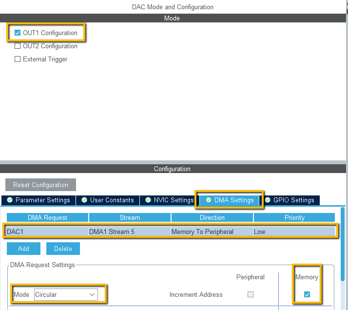

 * Enable DMA controller clock
static void MX_DMA_Init(void)
 /* DMA controller clock enable */
 __HAL_RCC_DMA1_CLK_ENABLE();
 /* DMA interrupt init */
 /* DMA1_Stream5_IRQn interrupt configuration */
 HAL_NVIC_SetPriority(DMA1_Stream5_IRQn, 5, 0);
 HAL_NVIC_EnableIRQ(DMA1_Stream5_IRQn);
