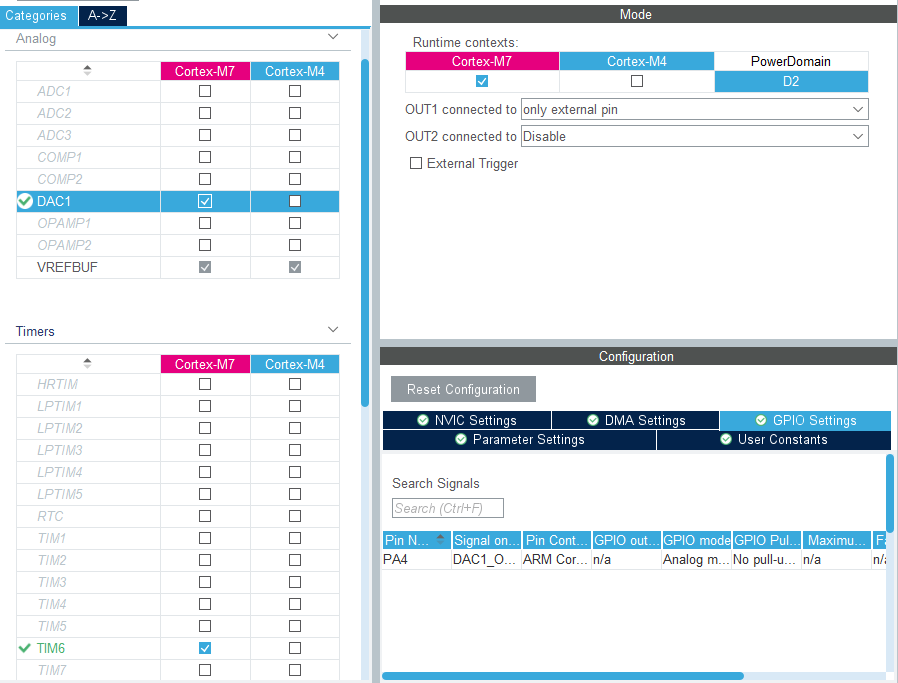

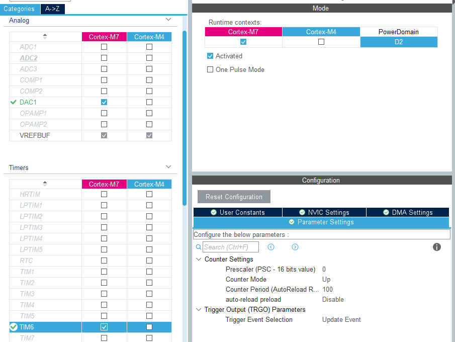

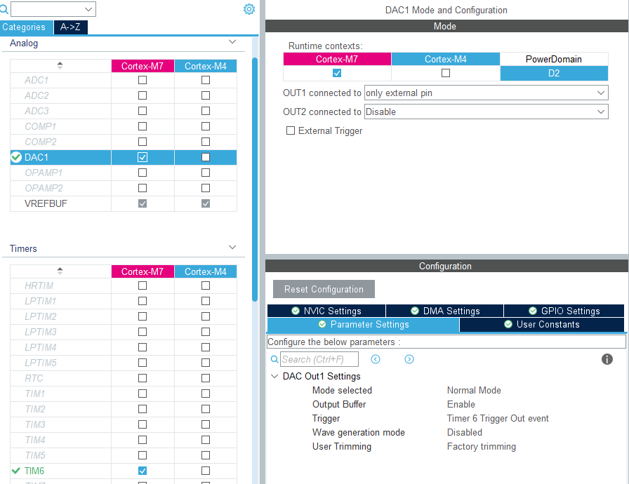

I followed a tutorial on how to generate a SINE wave using DAC and DMA that was really good. Logically it makes sense, you set up the DAC, set it to be triggered by a timer, then set up the DMA channel, set it to circular, and set it to use a table of values. Start the time and the DAC DMA, should work, right? Not working for me unfortunately, no output on the PIN PA4. Here are some screenshots of my CubeMX and a snippet of my MAIN Code:
/* USER CODE BEGIN 0 */
#define NS 128
uint32_t Wave_LUT[NS] = {
  2048, 2149, 2250, 2350, 2450, 2549, 2646, 2742, 2837, 2929, 3020, 3108, 3193, 3275, 3355,
  3431, 3504, 3574, 3639, 3701, 3759, 3812, 3861, 3906, 3946, 3982, 4013, 4039, 4060, 4076,
  4087, 4094, 4095, 4091, 4082, 4069, 4050, 4026, 3998, 3965, 3927, 3884, 3837, 3786, 3730,
  3671, 3607, 3539, 3468, 3394, 3316, 3235, 3151, 3064, 2975, 2883, 2790, 2695, 2598, 2500,
  2400, 2300, 2199, 2098, 1997, 1896, 1795, 1695, 1595, 1497, 1400, 1305, 1212, 1120, 1031,
  944, 860, 779, 701, 627, 556, 488, 424, 365, 309, 258, 211, 168, 130, 97,
  69, 45, 26, 13, 4, 0, 1, 8, 19, 35, 56, 82, 113, 149, 189,
  234, 283, 336, 394, 456, 521, 591, 664, 740, 820, 902, 987, 1075, 1166, 1258,
  1353, 1449, 1546, 1645, 1745, 1845, 1946, 2047
/* USER CODE END 0 */
 * @brief The application entry point.
 * @retval int
int main(void)
 /* USER CODE BEGIN 1 */
HAL_DAC_Start_DMA(&hdac, DAC_CHANNEL_1, (uint32_t*)Wave_LUT, 128, DAC_ALIGN_12B_R);
  HAL_TIM_Base_Start(&htim2);
 /* USER CODE END 1 */
Any help / thoughts are appreciated!
-Kneepatch

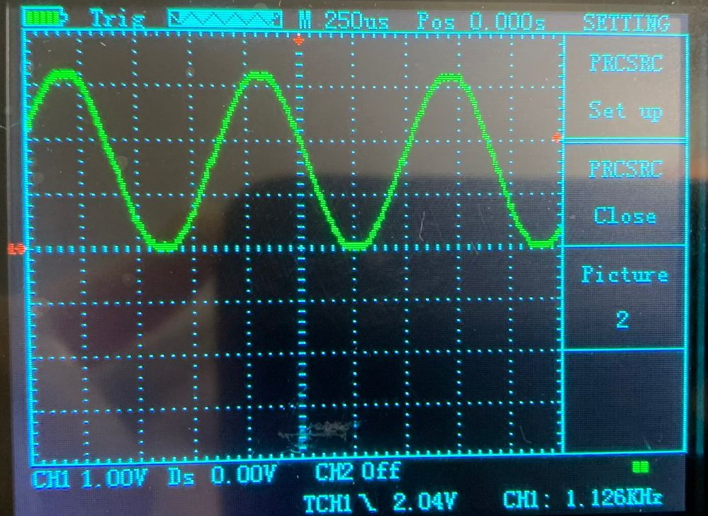

Thanks TDK and Georgy! I appreciate the detailed answer about DMA memory, I will keep the CONST in mind for the future.
Turns out it was where I put my DMA transfer start call. Putting it in USER CODE BEGIN 2 did it. Can't believe that I missed that. Thanks so much! Here is the beautiful end result:
-Kneepatch
That was it, thanks again!
-Kneepatch
