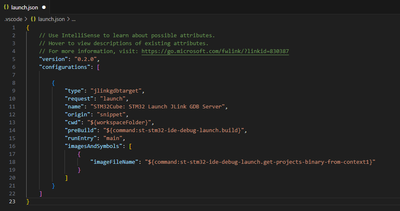

vincent_grenet
@Vmanne I've noticed you're reliyng on <=2.2.1 extension. Be aware a more recent pre-release one is available. It offers new debug experience including JLink support.
