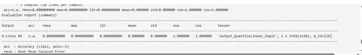

Julian E.
Hello @Hamanken
Could you run a validate on target to see if you get a good COS, example:
In the process of using AI on a MCU you can lose accuracy at multiple steps:
  • When you quantize you obviously lose precision
  • When you convert to the C model on x86 host
  • When you run it on the Arm based MCU you could also have a different behavior due to diff with x86.
By looking at the cos with the model running on target, we can first see if this seems to come from your model or from your code.
Have a good day,
Julian
