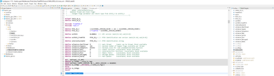

You can notice that "cmsis_os2.h" exists under cmsis_os.h File and this behavior does not cause compilation errors.
