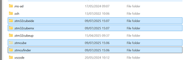

I am currently using STM32CubeIDE version 1.16.0 and facing an issue during project creation. The STM32Cube project option remains greyed out, regardless of the MCU or board selected (e.g., STM32L476RGT6, STM32H747I-DISCO).
Even if I proceed with the "Empty" project type, the .ioc file is not generated, and the CubeMX interface does not open.

I have attached an image below for your reference.

Hello @SaiGaneshCS
I recommend you to use the latest version of STM32CubeIDE 1.19.0 ,it works correctly .
if you want to keep using 1.16.0, please try to:
-Close STM32CubeIDE
-Delete all those files from your PC: .stm32cufinder, .stm32cubemx, .stm32cubeide and .stm32cube
then restart the STM32CubeIDE and retest again.

Jul 15, 2025 12:05 PM UTC
Thanks, it worked.
