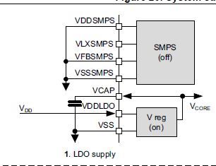

I have essentially the same issue on a STM32H7A3.
  1. __HAL_PWR_VOLTAGESCALING_CONFIG(PWR_REGULATOR_VOLTAGE_SCALE0);
  2. while(!__HAL_PWR_GET_FLAG(PWR_FLAG_VOSRDY)) {} // <--- FREEZES HERE
The strange thing is that the problem occurs sometimes.
While sometime the device works properly. Even for long period, let's say
the board can work properly for some week.
I supposed it can be tied to the power supply but I can't see
any issue in the design. By the way I'm using LDO supply configuration
providing a regulated 3.3V to the device.
0693W00000GZQnwQAH.jpgI've checked the configuration and is all connected as suggested by the
manual.
Did someone managed to understand the origin of this issue?
Thanks. I have a board with external 3v3 supply tied to all the power pins and same behavior - won't start up in standalone, debug sessions would work if started up into system bootloader (pulling boot0 to 3v3).
What is strange - debug connection works even with PSU configured with SMPS if you comment out the check for VOSRDY. I would expect it to fail, since SMPS output messes with the rest of the power bus, but I guess it's an impedance thing. Didn't actually measure.
Setting source to LDO and scaling to 0 helped.
