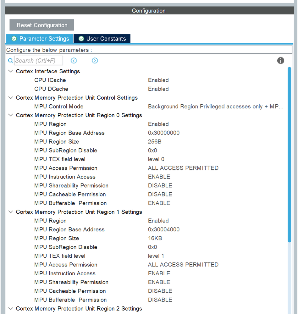

I am using CubeIDE Version: 1.6.0 Build: 9614_20210223_1703 (UTC) to initialise the MPU as it is done for the TCP_Echoserver, however the LL resulting code does not set the LL_MPU_TEX_LEVEL1 bit for the second region
Generated code:
/* MPU Configuration */
void MPU_Config(void)
/* Disables the MPU */
LL_MPU_Disable();
/** Initializes and configures the Region and the memory to be protected
LL_MPU_ConfigRegion(LL_MPU_REGION_NUMBER0, 0x0, 0x30000000, LL_MPU_REGION_SIZE_256B|LL_MPU_REGION_FULL_ACCESS|LL_MPU_INSTRUCTION_ACCESS_ENABLE|LL_MPU_ACCESS_NOT_SHAREABLE|LL_MPU_ACCESS_NOT_CACHEABLE|LL_MPU_ACCESS_BUFFERABLE);
LL_MPU_EnableRegion(LL_MPU_REGION_NUMBER0);
LL_MPU_ConfigRegion(LL_MPU_REGION_NUMBER1, 0x0, 0x30004000, LL_MPU_REGION_SIZE_16KB|LL_MPU_REGION_FULL_ACCESS|LL_MPU_INSTRUCTION_ACCESS_ENABLE|LL_MPU_ACCESS_SHAREABLE|LL_MPU_ACCESS_NOT_CACHEABLE|LL_MPU_ACCESS_NOT_BUFFERABLE);
LL_MPU_EnableRegion(LL_MPU_REGION_NUMBER1);
/* Enables the MPU */
LL_MPU_Enable(LL_MPU_CTRL_PRIVILEGED_DEFAULT);

Hi @Community member​ ,
Thanks for your feedback. I've been able to reproduce the issue from my side and I will report it internally to be reviewed by the development team.

‎2022-06-29 3:09 AM
This issue is fixed in STM32CubeMX latest release.
V6.6.0 is now available under this Link.
Thanks for your contribution.
