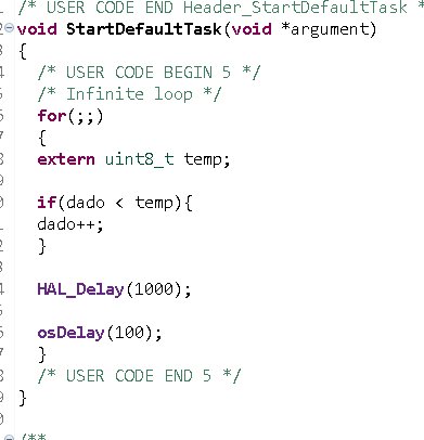

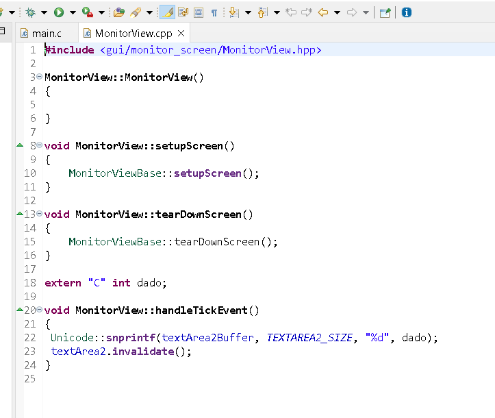

Hello everyone, I hope you can help me!!!
I'm at the beginning of programming in C++, and I'm having difficulty taking a variable from my main.c file to my screen created in touch gfx.
This error appears, where it apparently does not find the variable declaration.

build/MINGW32_NT-6.2/gui/src/monitor_screen/MonitorView.o: In function `ZN11MonitorView15handleTickEventEv':
C:\TouchGFXProjects\MyApplication_2\TouchGFX/gui/src/monitor_screen/MonitorView.cpp:22: undefined reference to `dado'
collect2.exe: error: ld returned 1 exit status
generated/simulator/gcc/Makefile:160: recipe for target 'build/bin/simulator.exe' failed

I followed what the course instructor said, but apparently it doesn't work.

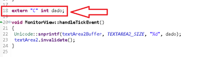

I am not sure the value "dado" is in other .c file (ex : in main.c)
If yes, you can try modify line 18 to "extern int dado;"
BADAAuthor
September 4, 2024
Hi, I removed the "C" and recompiled, but the same error appeared, I'm trying to backend an analog reading in main.c to the screen, I'm going to send the more simplified file of the project.
September 5, 2024
I can build your project in STM32CubeIDE 1.16.0 with touchGFX 4.24.0. Did you try to reinstall them ?

Looks like you're trying to take a short cut and not using MVP approach.
See this video tutorial on how to pass a variable, in this case an ADC value, from main to the Presenter
https://youtu.be/EbWOv_0Lp-U?si=s2OKKDyJN6vpb-3a
If a reply has proven helpful, click on Accept as Solution so that it'll show at top of the post.CAN Jammer an open source CAN bus hacking toolCANableV3 Open Source
BADAAuthor
September 5, 2024
Really, I was doing the wrong process, thank you for the help and reference!!

Regarding your question, since you created your variable from a TouchGFX file, you should include this file in your main.c.
Other than that, it is recommended to use the MVP design pattern to send or receive data from to GUI (TouchGFX) to the rest of the application (main.c and others). You can read more here : model-view-presenter-design-pattern
Here is a video tutorial to send data from a screen to the main.c : Touch GFX #8. Send Data from UI to MCU || UART
I hope this helps.
