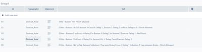

I am trying to update a text area called textTestArea with a string and I want to be able to format the string with a newline character.    Ex "I went to the store \n to buy food"

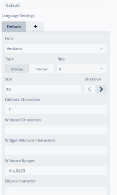

I created a texts called genericText that uses a default font that has wildcard range 0x00-0xFF ,  I also tried having range 0x20-0x7e and wildcard character 0x0A (/n)
here is the text and typography:
Here is the screen with text area:

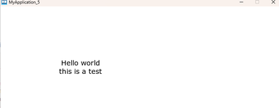

Hello @FJB2069 ,
I was able to use the \n but using strncpy function : 
void Screen1View::setupScreen()
    Screen1ViewBase::setupScreen();
    const char *myNewText = "Hello world\nthis is a test";
    Unicode::strncpy(textArea1Buffer, myNewText,  TEXTAREA1_SIZE);
    textArea1.resizeToCurrentText();
    textArea1.invalidate();

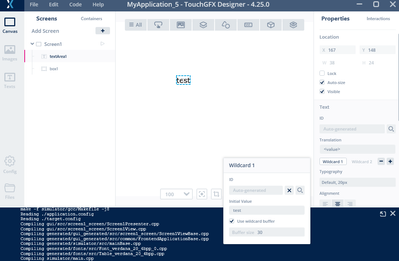

Here's my text config :
and my canvas :
Could you try that and let me know if that works?

Could it be the font I am using dies not have the newline character defined?  I read something about creating special characters as glyphs?
Could you use typed text in TouchGFX instead of programmatically assembling a multiline string? That's how I've been doing it, with no problems.
I tried using vendana font, no difference.

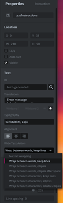

Another option is to add text wrapping to your text box, but I suppose you don't as much control around how it wraps.
Our text box is in a container,
And then our code chooses which of three errors to display (via custom title, image, and text) like so (sanitized version):
