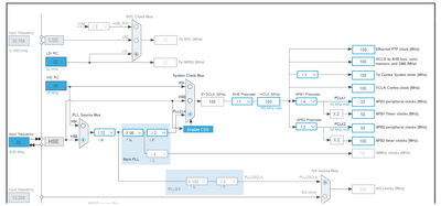

First, I tried test function in driver above with my board and working just fine displaying colors, fonts, and images. then I want to run my board with 100MHz clock and using CRC (because it's necessary for TouchGFX).
Second, I tried change the configuration, using 100MHz Clock and CRC, my board displaying test function just fine

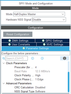

Does anyone know what happened? I have tried lower my SPI clock from 100MHz, 50MHz and 20 MHz, but my display still not showing anything.

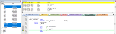

Thank you so much for answering my question, I have tried run the code in debugger, and I have to click "run" for several times like 3-6 times so the code will reach the while loop, and my code always got stuck here:
Reset_Handler PROC
EXPORT Reset_Handler [WEAK]
IMPORT SystemInit
IMPORT __main
LDR R0, =SystemInit
BLX R0
LDR R0, =__main
BX R0
ENDP
at BX R0, then I have to stop executing progress or reset debugger, then after that the code will get to register with function: BEAB BKPT 0xAB
If I run program several time (click the 'run' button several time), it'll change some registers then get to the while loop and execute my driver program normally. but after resetting the board or unplug-plug the power the display just show backlight

Thank you for replying! I thought all Error Handler of my interrupt code have been generated by cubeMX, I enabled SPI Interrupt and TIM2 Interrupt (the codes attached below). Are those code not error handler? Or should I add some code in while function inside void Error_Handler(void) at main.c?
and I think if the problem is the enabled interrupt, then my board will not displaying anything from the start, because I have enabled these interrupt since before TouchGFX added, and have not enabled additional interrupt. I only enabled CRC and TouchGFX, and running my code without TouchGFX function.
also I have found similar problem with error handler, they solve it by adding HAL_TIM_Base_Start_IT(&htim2); but this code not solve my problem.
