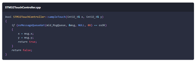

bool STM32TouchController::sampleTouch(int32_t& x, int32_t& y)
     * By default sampleTouch returns false,
     * return true if a touch has been detected, otherwise false.
     * Coordinates are passed to the caller by reference by x and y.
     * This function is called by the TouchGFX framework.
     * By default sampleTouch is called every tick, this can be adjusted by HAL::setTouchSampleRate(int8_t);
	int32_t xdata;
	int32_t ydata;
	// If a touch has been detected then read the coordinates and pass them to TouchGFX
	if (Touch_Detected())
		Touch_GFXGetData(&xdata, &ydata);
		x = xdata;
		y = ydata;
		return true;
	else
		return false;
 How is everyone else solving this? I feel like I must be missing something trivial.
