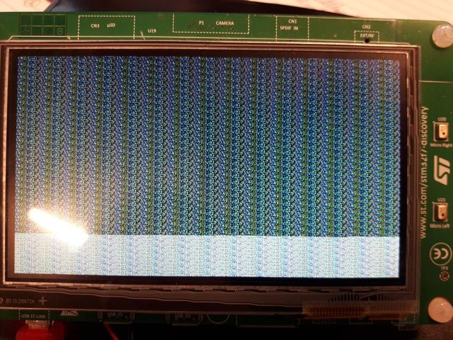

‎2020-10-29 12:13 AM
hello friend
Touchgfx does not work for me, I get the pixelated screen I use stm32cubeide 1.4.0 it does not work for me download version 1.2.0 and also download TouchGFX V4.14 and nothing, change the version ==> V4.13 and still some help friend , I hope you can help me ??
I made a simple program in touchgfx and there it works, but the detail is that I use LWIP in my program, I need to use it from stm32cubeide
