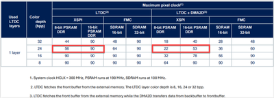

OK, so I think I figured out what is going on.  It appears I was violating the limit of the Pixel Clock limit of the MCU:
Using the LTDC and the DMA2D with the 8bit HyperRAM connected to OctoSPI2 appears to limit the Pixel Clock to 22MHz and with a 24bit RGB 800x480 display apparently working near 60FPS (I probed the VSync signal with my o-scope) puts the Pixel Clock calculation at 25MHz using the equations outlined here: https://support.touchgfx.com/docs/development/scenarios/running-graphics-from-external-ram#step-2-display-requirements-and-pixel-clock-calculations.
Even though my display datasheet says it should run the LTDC at 33.3MHz I tried underclocking the display at 24MHz using CubeMX which my o-scope showed the FPS down to 42FPS and the calculation saying my pixel clock is now near 17MHz.  This works perfectly now.  Unfortunately I don't think this is the proper way to reduce the FPS of the LTDC.  Is there away in the Code to to adjust this?  If so, where?  Or is this the correct way to set the FPS?
