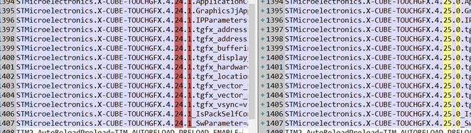

Dear Gfx Team,
I worked on a project using CubeIDE 1.17.0 and GfxDesigner 4.24.1.
I installed  and un-installed 4.25.0.
Now, when I open \TouchGFX\mcu_project.touchgfx with 4.24.1 and press F4/F5, the version in \mcu_project.ioc is changed from 4.24.1 to 4.25.0.
Why is that and how to stop it please ?
Thank you

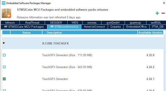

When you open STM32CubeMX, go into "Help" => "Manage embedded software packages" => "STMicroelectronics" => scroll down => "X-XUBE-TOUCHGFX", what version do you see there?

Thanks for your prompt reply.

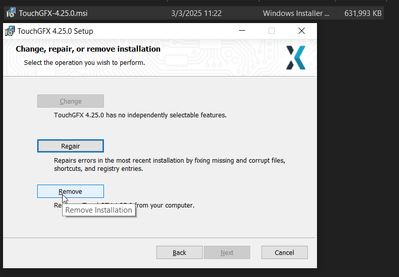

The windows program uninstaller is limited.
Try to look for TouchGFX-4.25.0.msi:
This is the installer and it can also uninstall.
This installer is more aware of the environment used by TouchGFX.
I found it in C:/Users/myName/STM32Cube/Repository/Packs/STMicroelectronics/X-CUBE-TOUCHGFX/4.25.0/Utilities/PC_Software/TouchGFXDesigner
Perhaps your best bet is to uninstall using the TouchGFX Setup.
You can look for the TouchGFX-4.25.0.msi file directly with a software such as Everything or, if you don't find such file, re-install the version you want to properly uninstall.

I installed and uninstalled 4.25.0 as you suggested but no luck. I'll come to that later.
Before I installed/uninstalled 4.25.0, I searched for TouchGFX-4.25.0.msi
>> "Try to find [...] with a software such as Everything"
Yes, Everything is in my 'survival kit' since you told me about it - the tool is godsend.

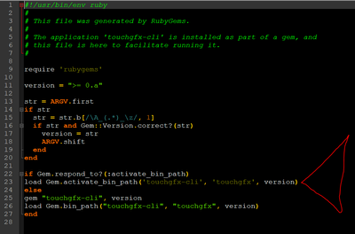

Now, there is this error when running 4.24.1:
Post Generate
touchgfx update_project --project-file=simulator/msvs/Application.vcxproj
C:/TouchGFX/4.24.1/env/MinGW/msys/1.0/Ruby30-x64/bin/touchgfx:23:in `load': cannot load such file -- C:/TouchGFX/4.24.1/env/MinGW/msys/1.0/Ruby30-x64/lib/ruby/gems/3.0.0/gems/touchgfx-cli-4.25.0/bin/touchgfx (LoadError)
from C:/TouchGFX/4.24.1/env/MinGW/msys/1.0/Ruby30-x64/bin/touchgfx:23:in `<main>'
Failed
line 23 in file "C:\TouchGFX\4.24.1\env\MinGW\msys\1.0\Ruby30-x64\bin\touchgfx" is here
load Gem.activate_bin_path('touchgfx-cli', 'touchgfx', version)
No idea where "activate_bin_path" could be set. I looked into my OS environment variables and nothing with 4.25.0 there.

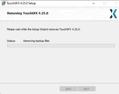

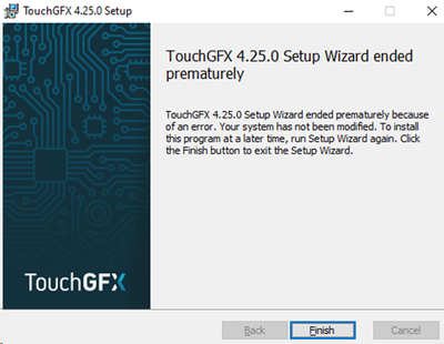

Back to 4.25.0 install/uninstall. During running uninstall from TouchGFX-4.25.0.msi, I got error screen. I copy here last 2 screens
What do you think ?
I forgot to say that with the error below, the .ioc is not changed now to 4.25.0.
