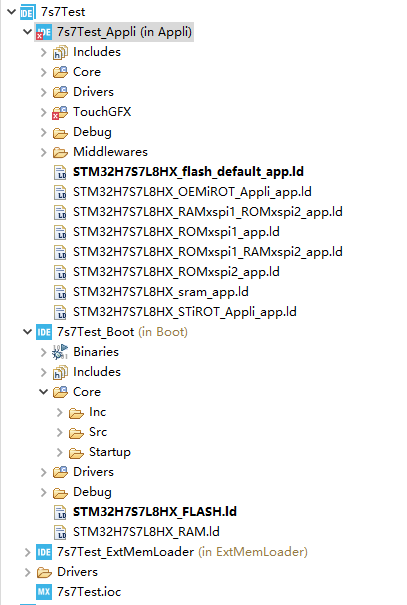

I made a test project for h7s7 using cubeIDE,the structure generated is below:
Then I opened touchgfx designer and import a blank UI, when I tried to build the project, a error came out:

Unable to locate D:/STM32CubeIDE/workspace_1.7.0/7s7Test/.cproject
Failed
Failed
The .cproject is actually located in D:/STM32CubeIDE/workspace_1.7.0/7s7Test/Appli/.cproject
but touchgfx designer goes to  wrong folder.

I made it work by copy .cproject file to  D:/STM32CubeIDE/workspace_1.7.0/7s7Test/,
but  not a elegant solution.

Hello @amb,
Since you create your project in CubeIDE and if you plan to Build on target from CubeIDE, this will not cause issue as the files are generated. The post generate is if you want to either run build simulator or on target from the designer.
