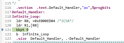

I'm trying to use ADC3 with BDMA on H753.
Started from some cube-generated code that assigned BDMA channel 0 to ADC3.
Allocated memory in SRAM4. Added interrupt handler for BDMA_Channel0 and ADC3.
When I start the ADC3, I hit the default interrupt handler - as if the proper handler is not defined.
ICSR = 0x891 this means the active interrupt is 0x91.
0x91 - 16 = 129 which is exactly BDMA_Channel0_IRQn.
And there's the handler for it. But this handler is not hit. Why??

Here it lands on the default handler, R1= 0x891

@Community member Jan, with separate handlers I get a weird result .. simply cannot believe my eyes.
This appears to be vector #1 (so I've mis-interpreted the ICSR; no need to subtract 16, the low bits of 0x91 b'10001 mean 17 ?)
Vector 1 is PVD_AVD_IRQn - interrupt from programmable voltage detector or analog voltage detector (RM0433, 5.5.3-5.5.4).
The RM says the interrupt must be enabled in EXTI and AVD/PVD must be enabled in PWR_CR1. When the interrupt is hit RWR_CR1 = 0xF000C100 so bits AVDEN and PVDE are both 0. (RM0433, 5.8.1)
I'm still checking if there is some error in my setup.
Have not increased the table alignment yet.
The interrupt remains active, I don't know how to block it. NVIC_DisableIRQ(PVD_AVD_IRQn) does not help.

2022-02-11 11:48 AM
> VTOR=80E0200
The alignment is not correct for this device. PM0253 section "2.4.4 Vector table":
The silicon vendor must configure the top range value, which is dependent on the number of interrupts implemented. The minimum alignment is 32 words, enough for up to 16 interrupts. For more interrupts, adjust the alignment by rounding up to the next power of two. For example, if the user requires 21 interrupts, the alignment must be on a 64-word boundary because the required table size is 37 words, and the next power of two is 64, see Vector table offset register on page 197.
According to RM0433 section "19.1.2 Interrupt and exception vectors" this device has 150 interrupts. Therefore the size of vector table is 16+150=166 words. The next power of two is 256 and therefore the VTOR for this device must be aligned to 1024 bytes.
In this case the closest correct addresses are 0x080E0000 and 0x080E0400.
2022-02-11 12:30 PM
The 0x91 is 0b1001'0001, which after multiplication by 4 (left shift by 2) becomes 0b10'0100'0100. Now, because the current VTOR address ends with 0b10'0000'0000, after OR operation the bit #9 is effectively ignored. That means the device actually fetches an address, for which the offset is lowered by 2^9=512 bytes or 128 words. That's why instead of fetching a vector 145 (0x91) it fetches 145-128=17, which translates (by subtracting 16) to 129-128=1 for interrupt numbers.
2022-02-12 12:04 AM
