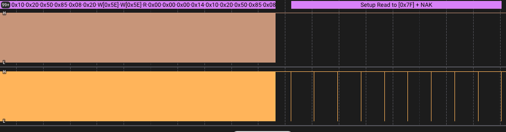

Here, visually, is what's happening as seen by a logic analyzer. In the below image, we can see the (lower) SCL line being pulled down periodically by the sensor. I can see in a debugger that the interrupt callback is indeed being called properly, and the read function attempts to run, but always returns HAL_BUSY, and we can see no pulses on the SDA line.

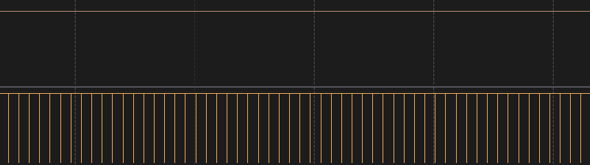

Below, in contrast, is what happens when I reset the I2C bus inside my read function (which I think is probably happening every time it fires). I would expect to see very small bursts of read transactions on SDA, with long periods of relative silence between the interrupt pulses. Instead, the read transaction seems to be constantly called, as though it is triggering interrupts itself, despite me disabling them in the code above when trying to do a read.

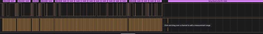

I don't know if this is a further clue, but observing my SDA/SCL lines with a log probe throughout the initialization process, I'm noticing the "Setup to read to [0x7F+NAK]" bit off to the right there. Does that indicate something amiss with the communication just prior?
December 18, 2024
The last transaction looks okay to me.
I would instrument the code to understand where HAL_BUSY is being reported. The contents of the I2C handle state machine can also offer clues. Is its state READY or something else?

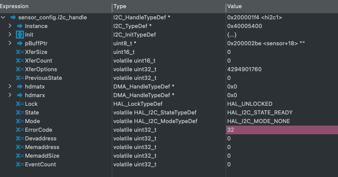

Hm, thanks for pointing me to this. I tried modifying my superloop to:

In the above, the HAL_I2C_IsDeviceReady() on Line 5 returns HAL_BUSY. When I expect the state of the handle at the this point, I see:
Stepping through the I2C DeInit/Init loop there, the I2C reset seems to work but HAL_I2C_IsDeviceReady() continues to report HAL_BUSY, and the handle state continually looks like:

If HAL_I2C_DeviceReady is returning HAL_BUSY, by "instrument the code" I mean set a breakpoint and figure out which line is returning HAL_BUSY and determine why. In this case, it has to be this line:
> I2C_WaitOnFlagUntilTimeout(hi2c, I2C_FLAG_BUSY, SET, I2C_TIMEOUT_BUSY_FLAG, tickstart) != HAL_OK
So the I2C_FLAG_BUSY flag is set. What does the manual say about that?

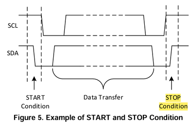

Your slave is pulling SCL low periodically, so it makes sense that flag would be set. How does it say it gets cleared? A stop condition.
So a stop condition is when SDA is low and SCL goes high. You'll need to generate that in order to clear the BUSY bit and let the peripheral progress. You can do that be reconfiguring the SDA/SCL pins as open-drain output, pulling SDA low, then pulling SCL low temporarily, then releasing SDA. Resetting the peripheral would also do the same thing. Something like:
__HAL_RCC_I2C1_FORCE_RESET();
__HAL_RCC_I2C1_RELEASE_RESET();
followed by re-initializing the peripheral.
Having a slave pulling SCL low periodically while the bus is idle violates I2C bus protocol, hence it will be annoying to deal with here.
