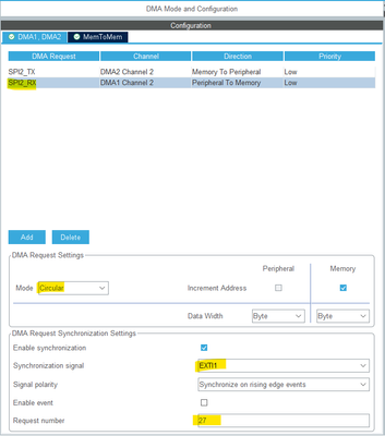

2024-07-20 2:39 AM - edited 2024-07-20 2:40 AM
>It can't be. Timers can be triggered from external pin, and then in turn trigger DMA transfer(s).
Why not? There is an option given in CubeIDE to synchronize by EXTI, so what is that for? Why should I trigger DMA by a timer instead of directly by EXTI1?
I have gone through the DMAMUX and DMA sections of the reference manual RM0432. It states:
"Each DMAMUX request line multiplexer channel x can be individually synchronized by setting the synchronization enable (SE) bit in the DMAMUX_CxCR register. If a synchronization event occurs while there is no pending selected input DMA request line, it is discarded. The following asserted input request line is not connected to the DMAMUX multiplexer channel output until a synchronization event occurs again."
This means that DMA would wait for the EXTI every time to start the DMA transfer, right?
I am using the STM32L4P5-DK and ADS131M08 ADC. I need to get 8 channel samples (27 bytes with status response). I am getting DRDY every 125 µs (8000 sps). So, DRDY signal is taken as EXTI1 and the request number is 27. Won't the below configuration work?
Regards ,
AJ
2024-07-20 2:45 AM - edited 2024-07-20 2:46 AM
The original thread is for 'F412, which does not have DMAMUX.
In newer STM32 such as the 'L4+, the picture is of course very different - not just DMA can be triggered directly from some pins (through "EXTI"), but also the v2 SPI does have a continuous selection of transfer width rather than just 8 and 16 bits in 'F4.
2024-07-20 4:48 AM
Hi Jan,
I resolved the issue with SPI2 being triggered by EXTI1. The problem was with the code generated by CubeMX, which did not set the number of request bits correctly. I manually set the bits using
*dmamux_c8cr_addr |= 0x1a << 19;
Since SPI2 is a full duplex master, how should I simultaneously enable SPI transmission to send dummy data to generate the clock and receive the ADC samples?
Regards,
AJ
2024-07-20 6:20 AM
You should externally trigger the DMA which performs the transmission; DMA which picks the received data should be triggered by SPI itself.
