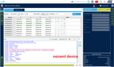

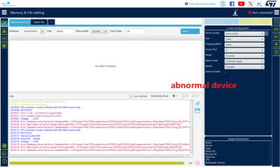

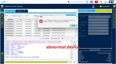

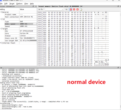

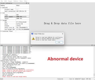

Everyone, latest update:
  • When using J-Link with STM32CubeProgrammer or J-Flash to read a normal device, communication works fine and Flash can be read successfully.
  • However, when attempting to read a faulty device with the same setup, various errors occur.
Additionally, STM32CubeProgrammer occasionally crashes when connecting to the faulty device.
Regarding the issue where STM32CubeProgrammer cannot read the Flash, I came across a forum post mentioning that the problem is often due to the chip not being correctly selected. However, in my case, the chip has already been properly recognized.
https://community.st.com/t5/stm32cubeprogrammer-mcus/missing-database-files/td-p/81261
SWD communication should be fine.
And the device has already been correctly identified.
