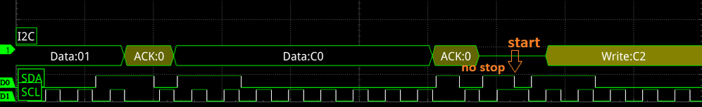

RM0394 (STM32L4..) in section 37.7.2 describing I2C_CR2.START bit states:
"setting this bit generates a START condition once the bus is free"
Section 37.4.8 reads:
"the master automatically sends the START condition followed by the slave address as soon as it detects that the bus is free (BUSY = 0) and after a delay of tBUF."
That sounds good. One may think that it is possible to queue in another transfer from HAL "transfer complete" event handler triggered by ISR.TXIS event. However, there seems to be a catch. In such case, even if CR2.AUTOEND bit is set, master does not set STOP condition before starting another transfer.

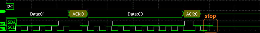

Single transfer properly ended with STOP condition.
Next transfer started from "transfer complete" event handler - STOP condition is missing.
Is what I described above a proper and expected behavior? I have doubts.

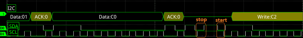

However, when CR2.AUTOEND is disabled, ISR.TC event fires, and if from within this TC event handler I set both CR2.STOP and CR2.START bits, master correctly sets STOP condition and then starts a new transfer. Wow!
Tested with STM32L432.
