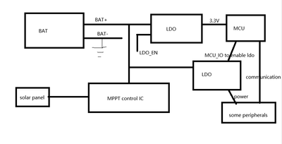

The device requires battery power.
This is the system block diagram. The LDO_EN signal can be considered as already enabled.

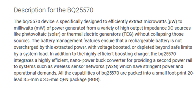

 An MPPT control IC refers to an integrated circuit similar to the BQ25570RGRR.
I’ll perform unified tests to read the BOR status, RCC_CSR register, and Flash contents tomorrow. Right now, the device is with other colleagues for analysis.
Yes, it's a 50 mAh battery that needs to be charged via a solar panel, using a chip similar to the BQ25570RGRR for control. (We didn’t select the actual BQ25570RGRR in the current design due to cost considerations, but we plan to switch to the BQ25570RGRR in the new version.)
We’re also working on optimizing the discharge-related aspects in parallel. However, since charging and discharging details aren’t directly relevant to this issue, I haven’t focused on describing them.
In the new reply, I attached a part of the system block diagram.
