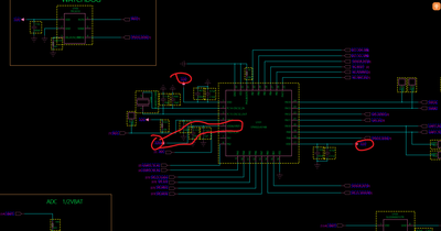

STM32L4 STOP2 System abnormal restart
daniaoday
Environment: STM32L4 + 32.768K LSE
Function: Wake up and work once every hour, then enter stop2 mode. During the one-hour sleep, wake up every ten minutes to feed the external watchdog.
Problem: The device resets directly when waking up every ten minutes.
Current known information: The device was tested in the company for over twenty days without any issues (including restarts, freezes, etc.). After the prototypes were given to customers, problems started to occur in about 10 to 20 days. Currently, there are two failed devices. After power cycling, the devices did not return to normal. External reset also did not restore them to normal. Re-flashing the devices allows them to operate normally, and they are currently under continuous pressure testing to see if the issue will recur.
Current debugging progress: When the device restarts, the nRST pin has a low-level time of less than 1ms. The 3.3V power supply pin of the MCU is stable as observed by the oscilloscope. The TP5010_DONE_Pin has a 40ms high-level time during each ten-minute wake-up period (HAL_Delay(1) --> SystemCoreClock configured at 80M, after low-power wake-up, it switches to the default 4M of MSI, reducing by 20 times, plus the HAL_GPIO_WritePin time, which is exactly 40ms), but during the first low-power entry, it has a high-level time of over 20ms (caused by unstable PLL switching to MSI?).

> A low level on the NRST pin (external reset) → No external reset signal was captured by the oscilloscope.
> However, actual measurements show that the low-level duration on the nRST pin is less than 1 ms.
I'm having trouble reconciling these two statements. You measured the NRST pin was low less than 1 ms (and presumably more than 0s?) but "no external reset signal" was captured? Isn't that the same thing?
If you have a scope capture of NRST when the reset happens:
Create a new project where IWDG is enabled and let it cause a chip reset. That will trigger the same internal pulse generator on NRST. Capture NRST during this event and compare the two. If they're the same, likely it was an internal reset, not external.
—> This specifically refers to the absence of the TPL5010’s 320 ms wide reset pulse.
I didn’t test using the IWDG; instead, I directly called HAL_NVIC_SystemReset(), and the observed behavior was identical.
The ~1 ms pulse width might be due to the RC time constant: τ = R × C = 10 kΩ × 100 nF (marked as "104") → τ ≈ 1 ms?
Ahh, okay, so likely an internal reset then.
Floating SWD pins will not cause a reset, nor will they affect system stability.
I'm afraid all the potential reset causes are what you listed above. Given your scenario, I think BOR reset is the most likely, though of course this will not happen if power is sufficient.
Yes, but the oscilloscope monitoring the 3.3V power rail showed no voltage fluctuations.

Plus your schematics show VDDA connected, but where ?
I used an oscilloscope to measure a 3.3V signal, and it showed no fluctuations. (Due to the bandwidth limitation of the oscilloscope, nanosecond-level fluctuations might not be captured.) Additionally, I've placed a 100nF capacitor on each power pin—could this issue still occur?
The oscilloscope confirmed the 3.3V signal.
Unless you were monitoring 3.3V at the time the reset on NRST happened, it means very little. The 4.7 uF bulk caps will ensure power doesn't drop too quickly to see (barring a short).
> mounted on poultry
haha. Was not expecting that.
> why does simply re-flashing the firmware restore normal operation?
Were the contents changed? Would be useful to check before erasing what was on there.
The flash has error correction. Exceedingly unlikely anything happened there. ECC will cause a hard fault or other non-recoverable error, not an internal reset.
> we conducted a water-spray test on a pre-shipment unit without its enclosure and observed a similar symptom—this might be a promising lead?
Sure is. See if you can read out RCC_CSR on there when it happens.
The newly programmed firmware is the same as the original.
The oscilloscope captured 3.3V on one channel and nRST on the other, with the nRST channel set to trigger mode. It was found that when the nRST signal had a falling edge, there was no fluctuation on the 3.3V line.
